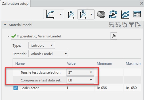

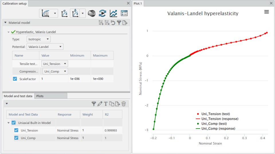

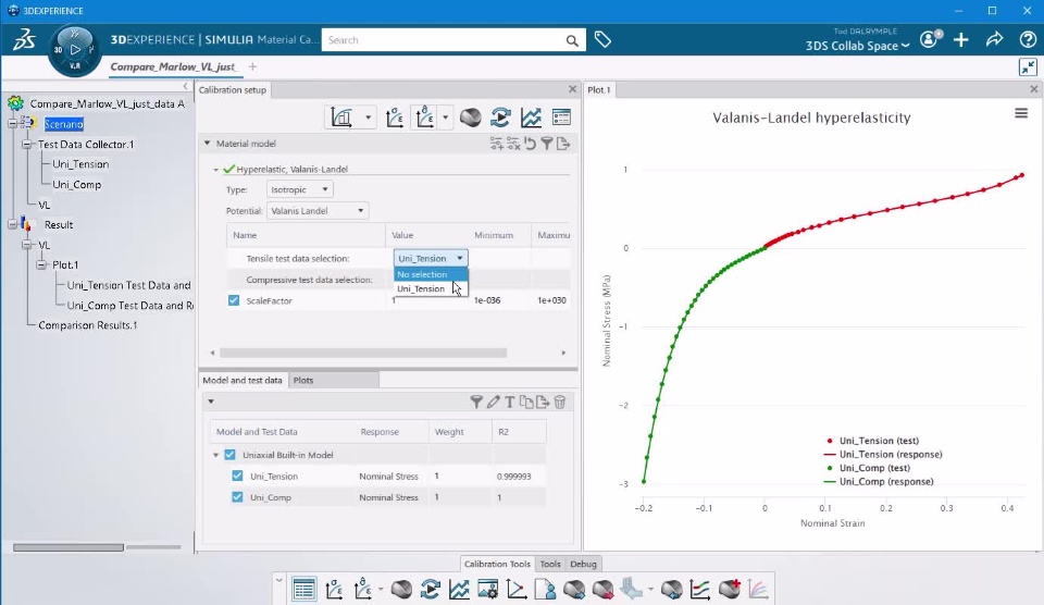

In R2023x FD01 of the 3DExperience Platform, the Valanis-Landel material model has been added to the material calibration app. In the calibration app's user interface, the user selects one uniaxial tension test and one uniaxial compression test to define the VL model. Reminder: in the calibration app, the Marlow model is defined by choosing one uniaxial test (either tension or compression, but not both).
In this demo video we show how one selects the Valanis-Landel hyperelasticity model in the calibration app and make a few comments about the quality of the fit.

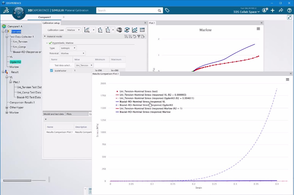

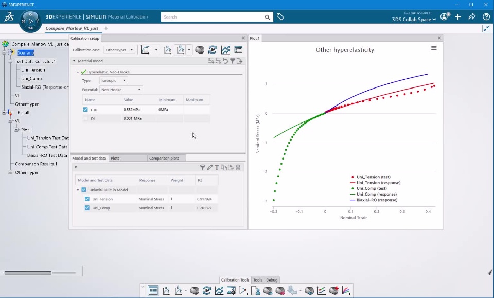

In the video below, we use the "calibration case" new feature to show a comparison of the VL model to other hyperelasticity forms.
In this 3rd and last video, we create a 3rd calibration case and show a comparison to the Marlow model.
Update: In the 2023x FD02 release of Abaqus, the VL model was updated to allow the use of Biaxial Test Data. The material calibration app was also updated to all this usage:
