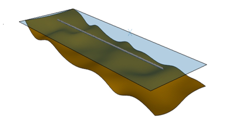

The traditional lay procedure for offshore pipelines on an uneven seabed typically involves modelling an initially straight pipeline in contact with a flat rigid surface while subjected to gravity and external pressure. The rigid surface is then lowered through a 3D seabed profile, allowing the pipe to settle in contact with the real geometry. Once laid, the pipe is normally subjected to an internal pressurise and thermal loading, which can cause the pipe to locally buckle. This method provides additional support to the pipe during the lay procedure, making the problem easier to solve using the general static procedure. It does not account for the effects of lay tension; however it can provide an indication of on-bottom roughness and free span potential.
- Initial Configuration
- Final Configuration

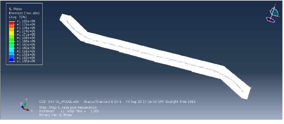

The following ‘real-life’ example has been solved using both approaches and the results are very comparable, however the total run time decreases by a factor of four.
- Traditional approach (General Static Procedure)
- New approach (Implicit Dynamic Procedure, using QUASI-STATIC option)
