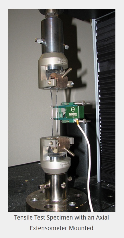

The image above shows the use of a clip-on extensometer to measure the displacement in the center region of a uniaxial dogbone specimen.  There are a variety of reasons why one might want to model the entire dogbone specimen and use the extensometer test data as part of an FE mode calibration.  This post shows a worked example of how to do this.

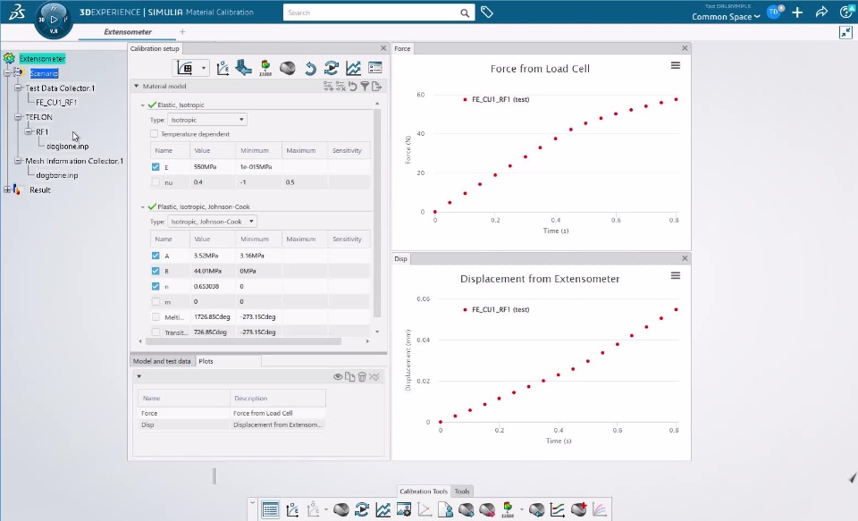

In the image below we show the force-time and the CU1-time.  The test data is synthetic.  The test data was imported as a single dataset. Outside of the calibration app the dogbone model runs in ~38 secs.  Units are N, mm, MPa.

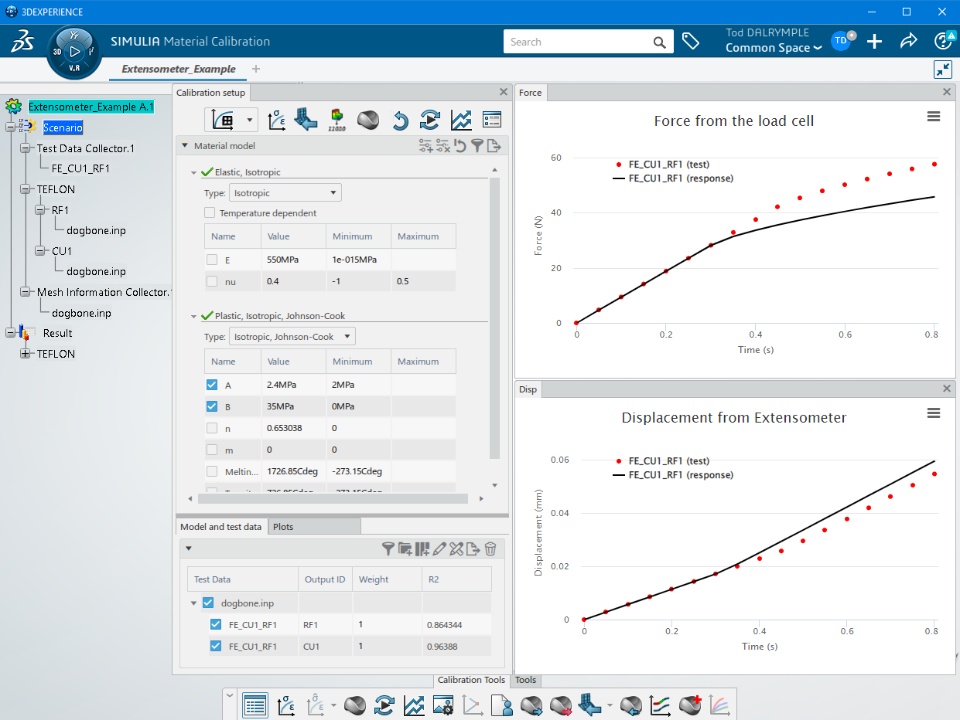

The image below shows the initial set-up of the calibration.  I have perturbed the material model by changing the Johnson-Cook A and B parameters.  In this image we show a Force-Time plot and a Displacement-Time plot.

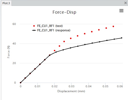

If we desire we could also plot the Force-Displacement :
