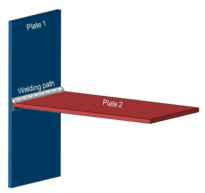

The weld set-up used in this demonstration
The image above shows an example of a simple weld optimization, using two plates of nickel-based superalloy IN625 measuring 200 × 100 × 5 mm. The welding simulation utilizes Abaqus software for sequentially coupled thermo-mechanical analysis, employing the Additive Manufacturing (AM) process simulation interface for flexible definition of welding paths, parameters, and heat flux distribution. A dataset of 80 simulations varying welding power (400-600 kW), speed (0.5-1.0 m/s), and torch angle (30-90 deg) is generated. 64 of these are used to train a neural network-based AI model, with the remaining 16 used to test it.

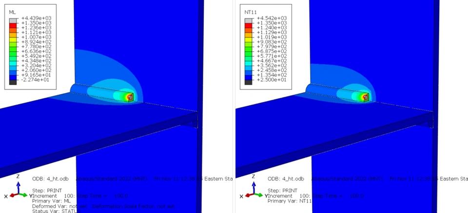

The trained neural network acts a surrogate model of the welding process. Once trained, it can calculate the 3D deformation and residual stress almost instantly for new parameters, representing a speed-up of over 100,000% compared to simulation alone. The model can generate many different types of result, including melt pool shape, temperature distribution, distortion and residual stress. The surrogate model shows excellent accuracy, with around 0.1% error in maximum deformation compared to the reference simulation.
Temperature field and melt pool evolution test prediction from machine learning (left) and reference FEA simulation result (right)
