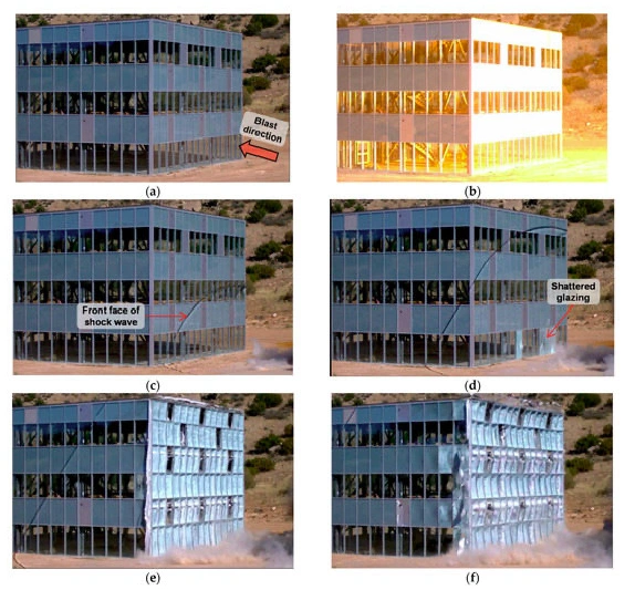

The analysis of load-bearing capacity and the determination of blast protection levels for glass facades represent a crucial design and research challenge. In current practice, these issues are primarily addressed through time-consuming and expensive experimental investigations on full-scale samples. To streamline this process, numerical simulations offer a powerful tool for supporting the design process. This contribution presents a Finite Element (FE) numerical approach, implemented in Abaqus, to investigate the mechanical performance of glass facades under blast scenarios. The study focuses on a facade composed of an aluminum frame and a Triple Glass Unit (TGU), a widely adopted glass component in modern buildings characterized by multiple laminated glass (LG) layers separated by gas-filled cavities. To accurately represent the bending behavior of the TGU, the gas-structure interaction is modeled using a fluid-cavity interaction. In addition, glass breakage and interlayer tearing are accounted for by implementing constitutive models for brittle cracking and ductile damage, respectively. Finally, potential contact between facade components is managed through a surface-to-surface contact interaction, while the blast load is applied as a pressure-time history function based on the Friedlander equation.
