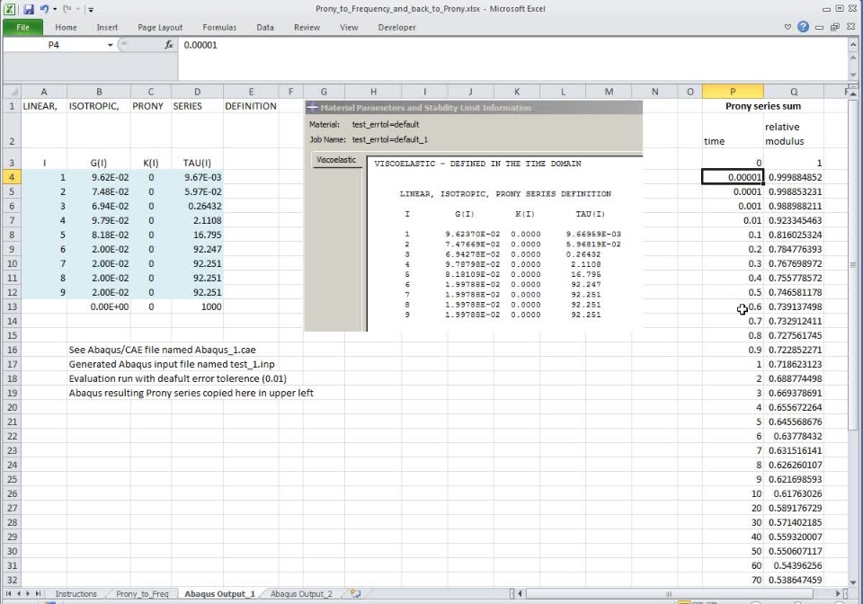

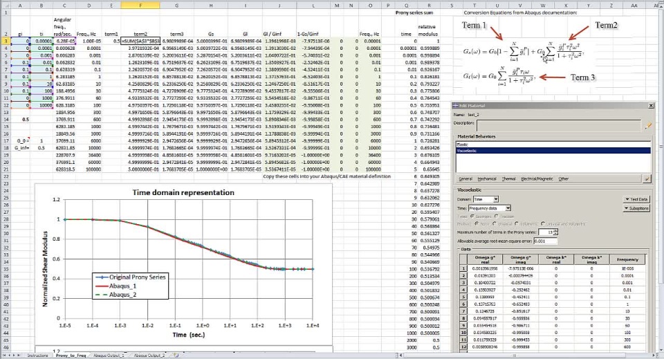

This interconversion math is not all that complicated, so it is worthwhile to show what happens in an Excel spreadsheet.  As I've said before, I like using Excel for this type of thing because it is so transparent (and ubiquitous).  We can show test data, graphs of the test data and transparently show the equations used to convert the data.  Please click on the links at the bottom to see a narrated video that describes this Excel spreadsheet with an interconversion from Prony terms to Storage and Loss moduli. The Excel spreadsheet is also attached for download.  I'd like to thank my friends and colleagues at the SIMULIA Erie office for kindly providing this Excel spreadsheet.
There are some instructions on the first tab of the spreadsheet, it would be good to review these prior to viewing the video:
Filename:   Prony_to_Frequency_and_back_to_Prony.xlsx

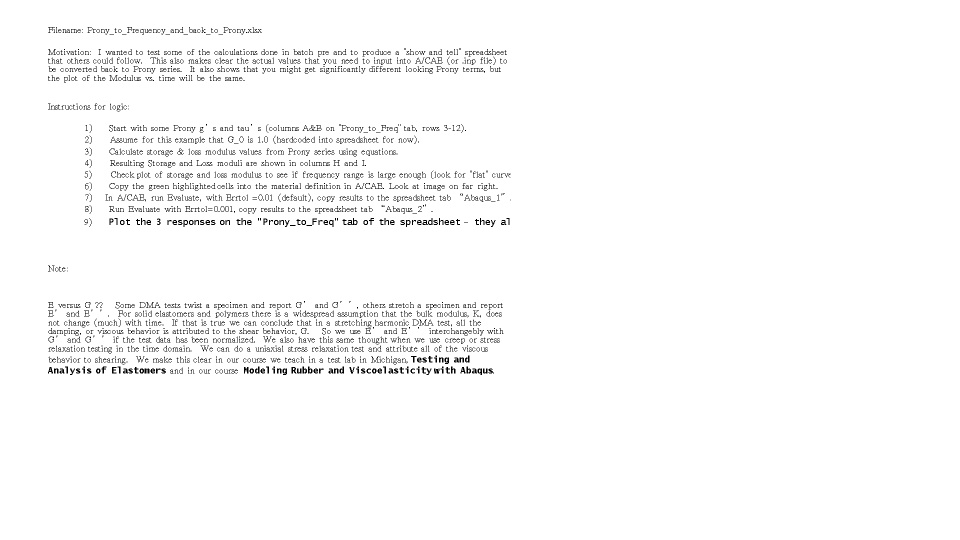

Motivation:  I wanted to test some of the calculations done in batch pre and to produce a "show and tell" spreadsheet that others could follow.  This also makes clear the actual values that you need to input into A/CAE (or .inp file) to be converted back to Prony series.  It also shows that you might get significantly different looking Prony terms, but the plot of the Modulus vs. time will be the same.
Instructions for logic:
1)      Start with some Prony g’s and tau’s (columns A&B on "Prony_to_Freq"   tab, rows 3-12).
2)      Assume for this example that G_0 is 1.0   (hard coded into spreadsheet for now).
3)     Calculate storage & loss modulus values from Prony series using equations.
4)     Resulting Storage and Loss moduli are shown in columns H and I.
5)     Check plot of storage and loss modulus to see if frequency range is large enough (look for "flat" curves).
6)     Copy the green highlighted cells into the material definition in A/CAE. Look at image on far right.
7)      In A/CAE, run Evaluate, with Errtol =0.01 (default), copy results to the spreadsheet tab “Abaqus_1”.
8)      Run Evaluate with Errtol=0.001, copy results to the spreadsheet tab “Abaqus_2”.
9)      Plot the 3 responses on the "Prony_to_Freq" tab of the spreadsheet – they all match well.
