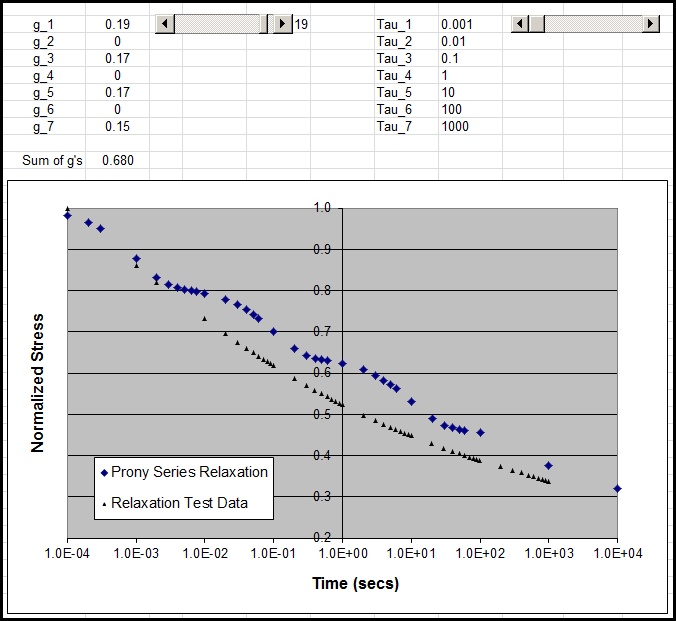

The narrated video below uses an Excel spreadsheet to show the shape of the Prony series equation. In addition the video gives some general rules of thumb on how many terms should be included in the series and how to derive the Prony coefficients from test data using Abaqus/CAE. (The video will play more clearly if downloaded first).
In the video, a comment was made that if too few Prony terms are used the response will look 'bumpy', or 'wavy'. In the image below we have used the spreadsheet (attached and downloadable) and given only 4 Prony terms (pairs of g's and tau's) over 7 decades of time - roughly one pair per 2 decades of time - and you notice the bumpy or wavy response of the Prony model (blue diamond symbols).

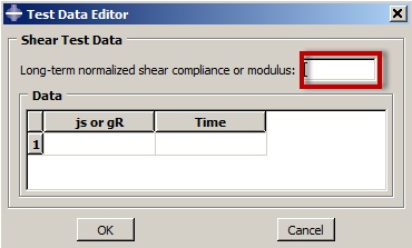

One last note, in the video, as we were entering the shear test data, the input dialog box (shown below) has a place to enter a value for the "Long-term normalized shear compliance or modulus". This is optional input and can help in the fitting, especially when you have a good idea of what the value at very long time (infinity) is. It is a best practice however to have material test data that spans the range of time (and strain) that you expect in your analysis.
