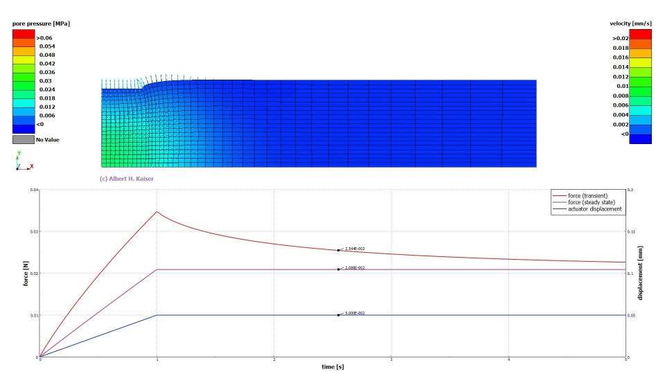

When I started getting interested in biomechanics, I made this little test example (zip) to get familiar with poroelasticity features in ABAQUS. It represents cartilage on impermeable subchondral bone and a permeable rigid indenter. Details can be found in the JoBM paper by Wu, Herzog and Epstein from 1997 (doi).
The model uses symmetric boundary conditions and axisymmetric elements. It runs with the ABAQUS  Learning Edition :-)  You don't need much imagination to visualize the cylindrical specimen (the left side is the center line). At the upper and right side free draining is allowed.  The animation shows the pore pressure and the velocity of the pore fluid, and the diagram shows the indenter displacement input and the corresponding transient reaction force (and the steady state force as a reference) as a function of the test time.
