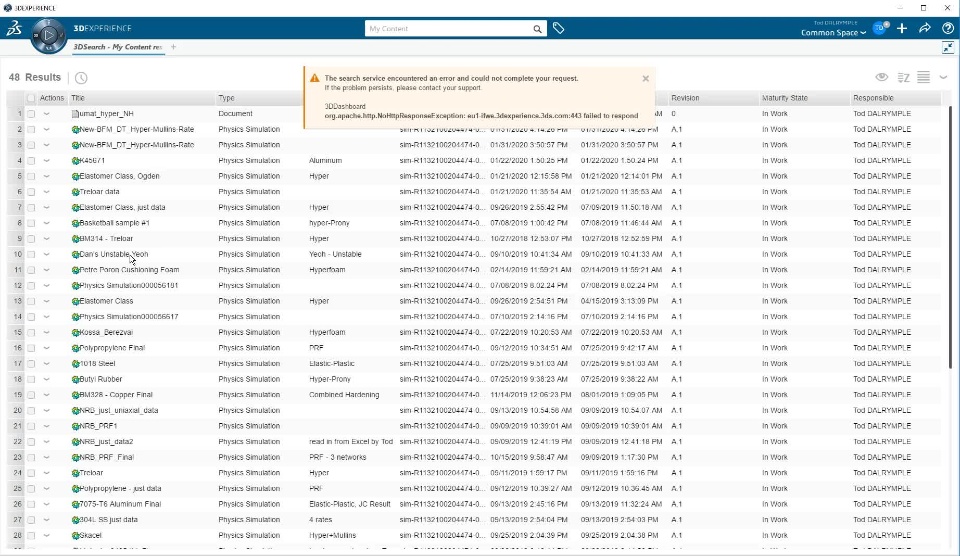

2)  Import the .dll file into the 3DExperience platform using "New Content" and "Document".

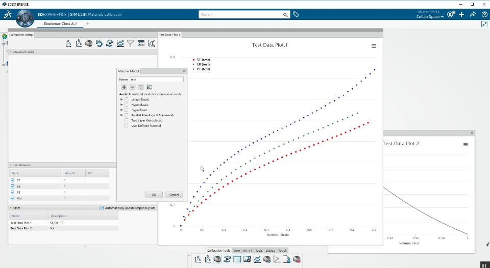

3)  In the calibration app, use numerical mode and associate, or attach, the dll document to the calibration object.
4) Select the User Defined Material as your material model and calibrate.
