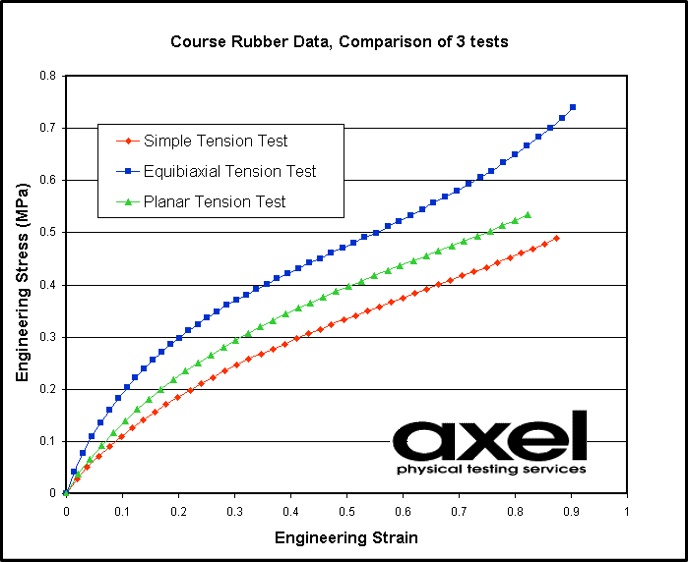

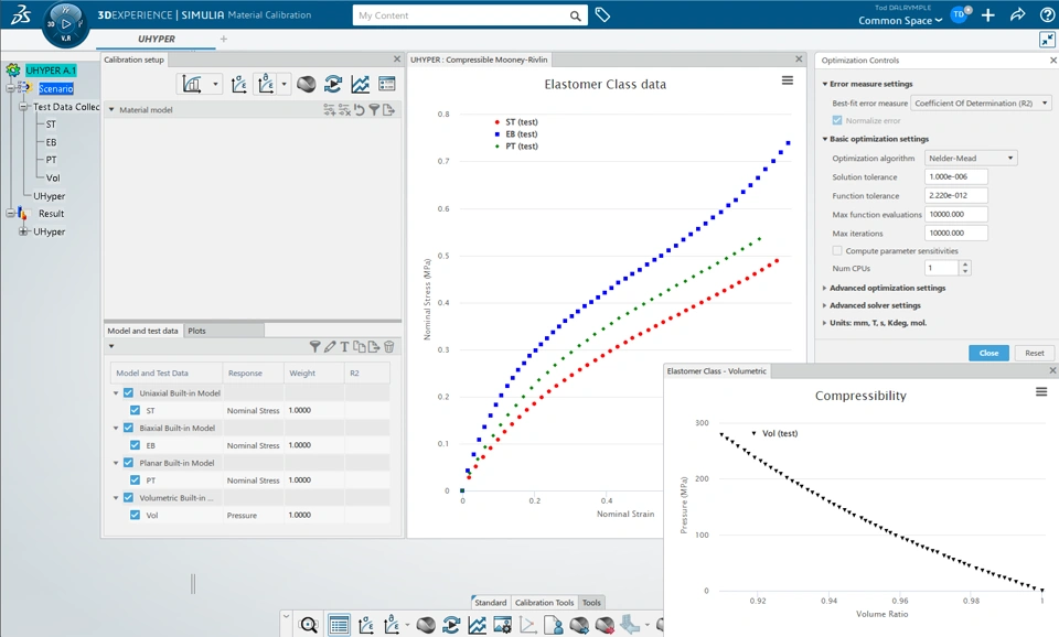

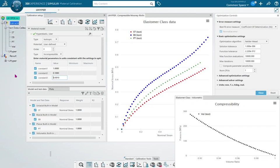

For this example, we will use the Elastomer Course test data, pictured above, and which contains some compressibility test data of volume ratio versus pressure. I've already set both my display units and my calculational units to N, mm, MPa.  This example uses the numerical mode in the calibration app.  Here is what the test data looks like in the calibration app:
The narrated video below starts from the above image, and:
  1. Selects hyperelastic as the material model, then selects the User-defined (which here means UHYPER).
  2. Imports the file "standardU.dll" which is a compiled version of the user sub, uhyper_umathrt3.for
    1. Name the compiled user sub "UHYPER_MR"
    2. In the Description field type in "Compressible MR ; 3 params"
  3. Type in some values for the 3 constants, C10, C01, and D1.  I typed in 1.0, 0.1, and 0.001

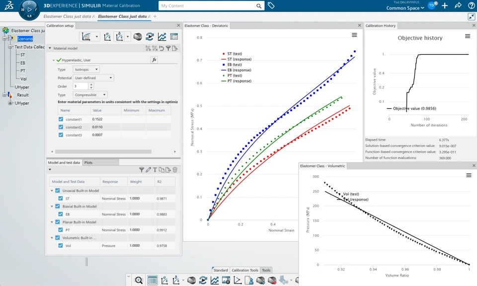

  4. Perform a calibration
The narrated video below was created on May 13, 2024 using the public cloud, R2024x HotFix 3.11
This is what things look like at the end of the video:
