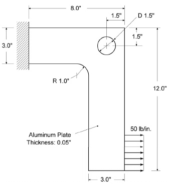

Tutorial - 2D Analysis of an Aluminum Bracket
The attached tutorial, created by Hyonny Kim of the University of California, explains how to sketch the 2D geometry and define the part, define the material properties, apply the loads and boundary conditions, mesh the part, run an analysis, and view the results of the analysis. The tutorial is fundamental level, deals with a linear and structural simulation, and takes about 3 hours to complete.
