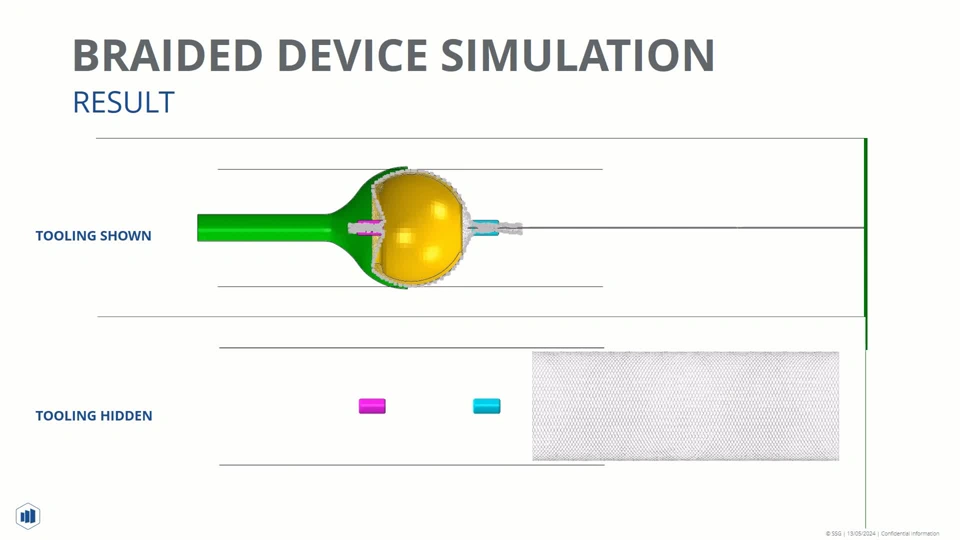

Slide 8 animation:
Abstract
Braided wires are often used in medical devices, such as catheters, guidewires, and other interventional tools. These wires are designed to provide flexibility and strength, making them suitable for navigating through blood vessels and other anatomical structures during medical procedures. Abaqus FEA can be used to evaluate and optimize the structural performance and manufacturability of these critical components. This presentation will discus a novel approach to modeling the manufacture of a braided-wire embolization device. The embolization device manufacturing steps are simulated to capture wire compaction at the marker sites. The completed device is annealed then crushed between two rigid plates so that the structural stiffness can be assessed.
