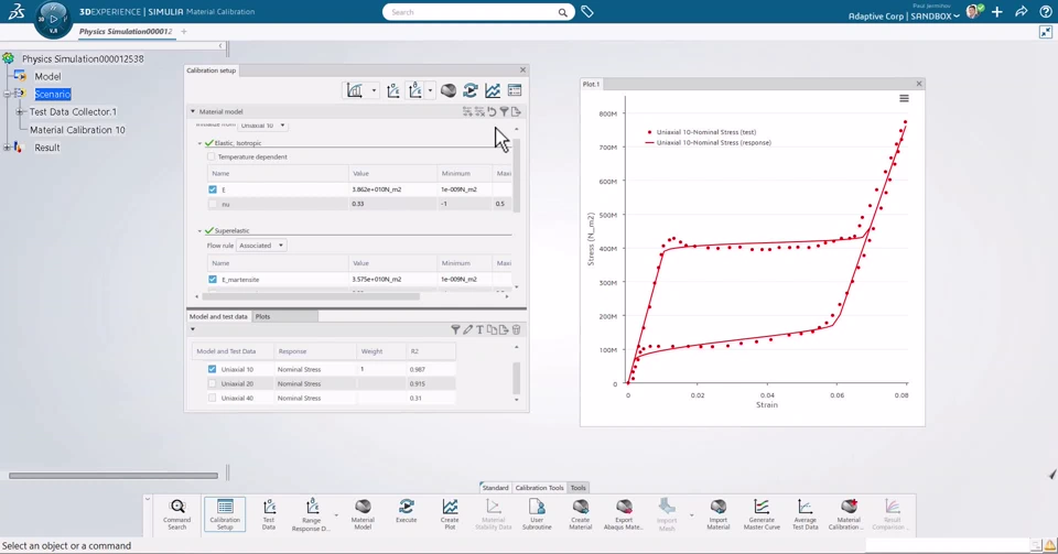

Nitinol, a unique shape memory alloy (SMA), exhibits remarkable properties such as superelasticity and the ability to recover its original shape after deformation, making it ideal for a range of applications in biomedical devices, actuators, and aerospace components. However, modeling the complex behavior of Nitinol in finite element analysis (FEA) requires careful consideration due to its nonlinear properties. This presentation works through a full material calibration of NiTiNol on the 3DEXPERIENCE platform. The integration of advanced material testing data into the simulation environment enhances model accuracy, while the application of optimization techniques and post-processing tools in both Abaqus CAE and 3DEXPERIENCE is discussed to ensure reliable and efficient design outcomes.
