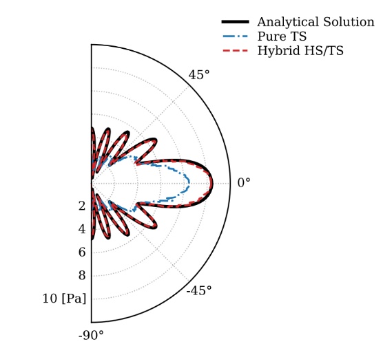

Computational fluid dynamics (CFD) can be used to simulate air flows around bodies such as aircraft. Well-established methods exist for simulating subsonic (below Mach 0.8) and supersonic (above Mach 1.2) flows. However, the transonic region is more challenging, especially as subsonic and supersonic flows can coexist. The simulation methods for subsonic flows cannot capture the behavior of flows around and above Mach 1, while the methods that can simulate highly-compressible flows have much higher computational costs and can suffer from increased numerical dissipation (Figure 1).
To tackle this problem and allow transonic flows to be simulated accurately but efficiently, SIMULIA PowerFLOW has introduced a new hybrid simulation method specially designed for the transonic region.
Figure 1: Acoustic directivity of a monopole, comparing the analytical solution to a pure transonic (TS) simulation and hybrid high-subsonic/transonic (HS/TS) simulation. The hybrid simulation shows much better results due to reduced dissipation.

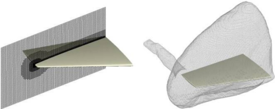

To allow the efficient simulation of transonic flows, PowerFLOW has recently introduced a new hybrid solver method. This uses the TS solver with high-order multilayer lattices only in specific regions with high-speed TS flow, while using the HS solver with a regular single-layer-speed lattice in the rest of the simulation domain containing low-speed flows. The interface between the two guarantees conservation of mass, momentum, and energy, and gives accurate flow transition between fixed and rotating reference frames and meshes. This ensures robust, reliable hybrid simulation.

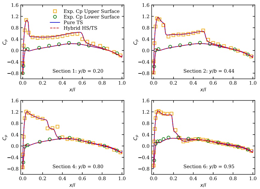

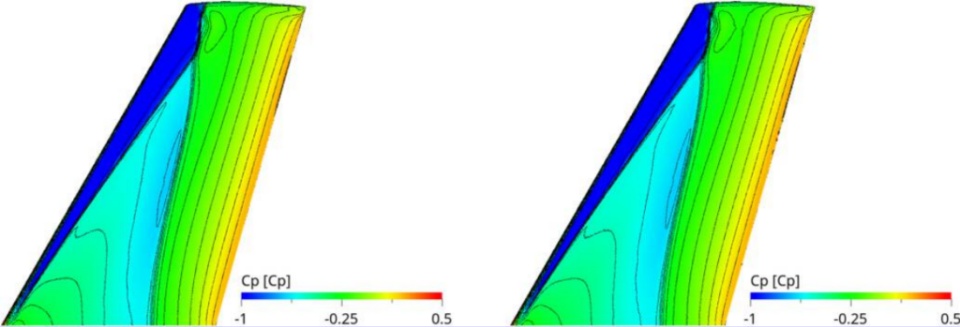

Hybrid HS/TS simulation offers results that are in line with both experiments and with the results from a full TS solver simulation (Figure 2 and 3), at much lower computational cost. In some cases, it offers even more accurate results due to the lower numerical dissipation (Figure 1). For more information about the implementation, see the paper “Hybrid Lattice Boltzmann Approach for Simulation of High-Speed Flows”.
Figure 2: The ONERA M6 wing model used for validation (left), showing the interface between the TS and HS regions (right).
Figure 3: Pressure coefficient (Cp) across different cross sections of the wing in Figure 2.
