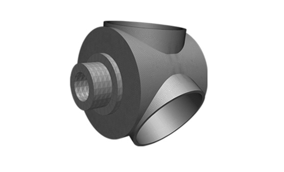

    Available design space

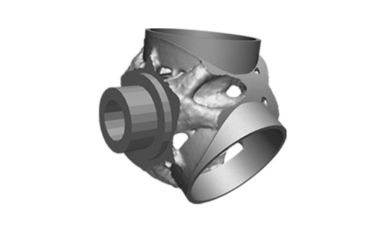

Topology optimization is applied to obtain a new optimized structural design with lower weight and higher stiffness. Based on the available design space Tosca Structure.topology iteratively removes material and redistributes material in the topology optimization process.
Tosca Structure.topology derives a new structural design which optimally carries the loads.
Symmetry and casting constraints are considered during the automated iterative optimization process ensuring a simple implementation of the new design proposal in the further development process.

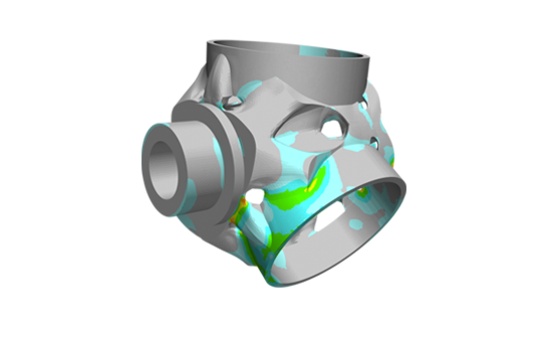

Additionally, a shape optimization using Tosca Structure.shape is run after evaluating the new topology optimized design. Tosca Structure.shape employs small but essential design changes at the surfaces of the components leading to a significant reduction of stress peaks.
    Topology optimized result with reduced weight

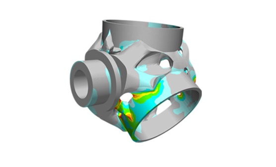

    Validation run of new design – showing stress distribution
    Shape optimization result with reduced stress peaks

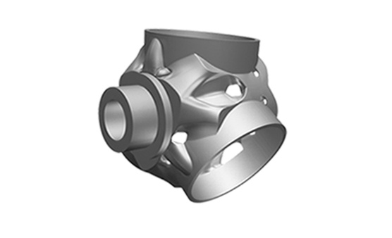

    Final optimized structure: Lightweight, stiff, and durable design
