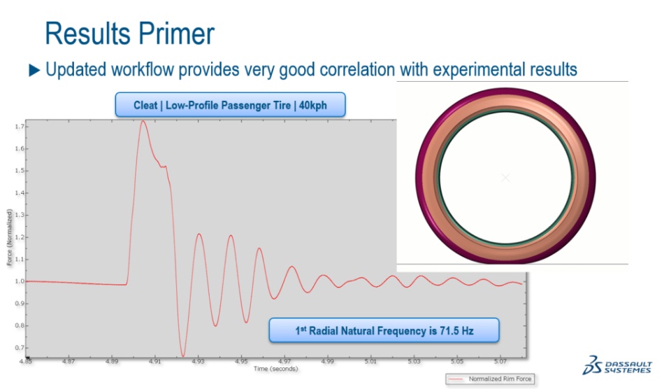

Results Primer

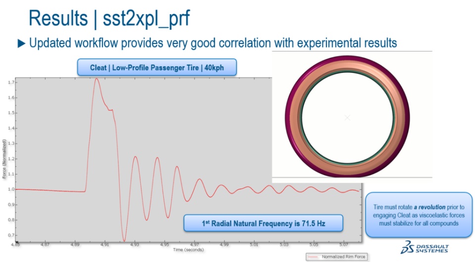

This Workflow provides very good correlation with experimental results, per image below.

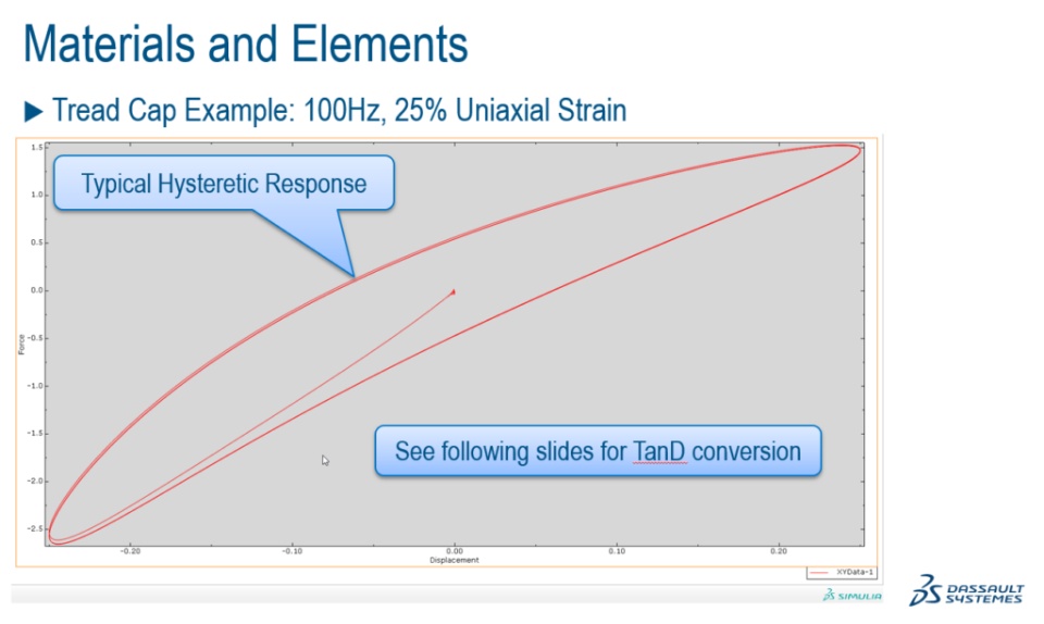

The hysteretic response is shown below for a typical Tread Cap compound.

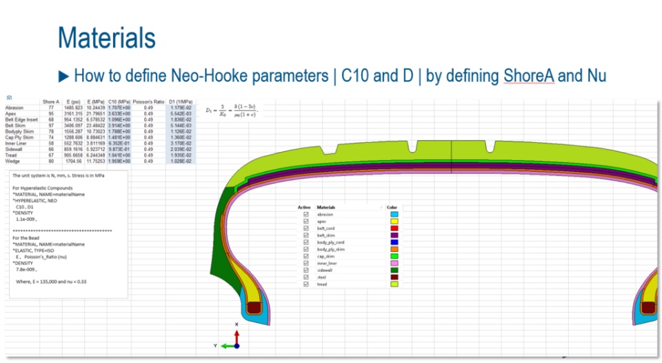

    • Hyperelasticity: Neo-Hooke. Employed to eliminate variability and accelerate fundamental understanding.
    • D1 defined à nu = 0.49 for all elastomeric compounds. This is quite typical and eliminates the need for Hybrid formulation elements.
    • Solid, reduced integration, non-hybrid elements employed
    • Surface elements employed for reinforcements

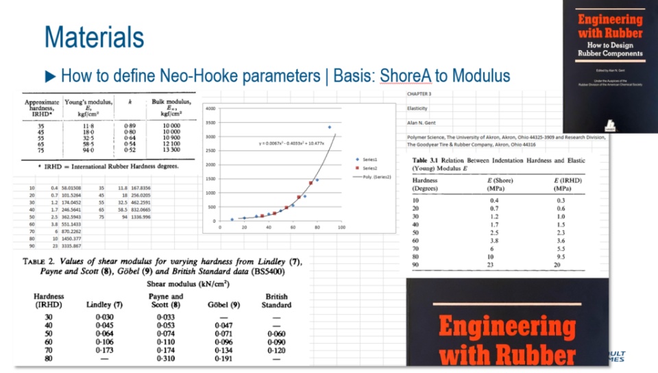

Hyperelastic response: if one curve-fits the data provided in [Engineering with Rubber 3E: How to Design Rubber Components, Book by Alan N. Gent], we can easily create neo-hooke C10s from Shore-A.

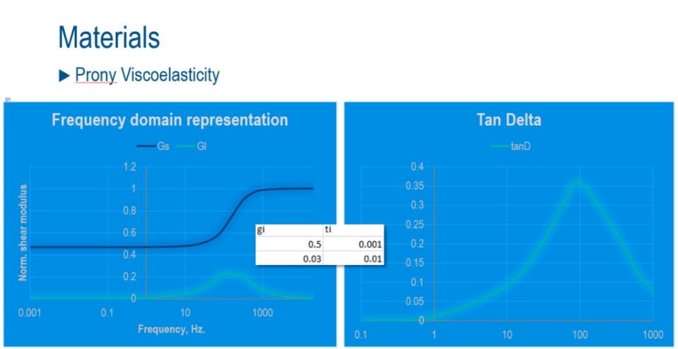

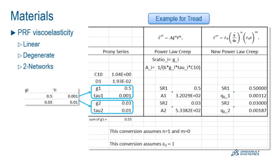

Viscoelastic response: we will generate a PRF material model for the abrasion, apex, belt-skim, bodyply-skim, cap-skim, inner-liner, sidewall and tread via conversion from a 2-term Prony model. The frequency domain and TanD representation is shown below, along with the G and Tau table used to create it. The first image is the Prony response, the second image details the conversion process.

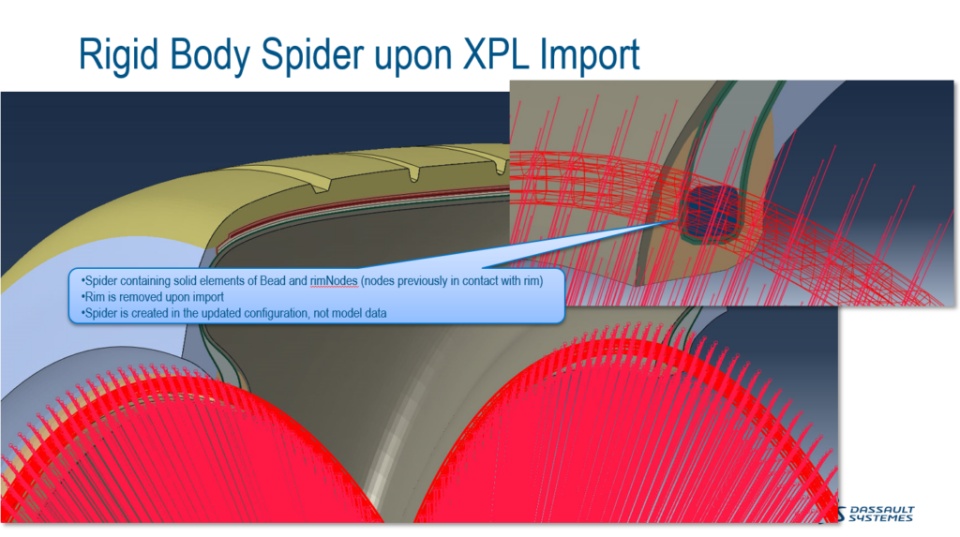

  4. Abaqus/Explicit | 3D | *IMPORT Abaqus/Standard 3D state
    1. *IMPORT, STATE=YES, UPDATE=NO (Python script developed for ELSETS import)
    2. Execute in a single Step
    3. Velocities are imported by default
    4. Instantiate the road at the correct vertical position from free-rolling SST
    5. Apply translational velocity to the road
    6. Remove rim contact and declare Bead and rimNodes as rigid body. Next image to detail

  • Two (2) Methodologies have been presented (Stay-tuned for Option-2); both of which show excellent correlation with physical test data.
    • Option-1: Abaqus/Standard *SST Free-Rolling to Abaqus/Explicit
      • Applicable for only Ribbed Tire geometry
    • Option-2 (Stay-tuned): Abaqus/Standard Centrifugal Loading to Abaqus/Explicit
      • Applicable for both full 3D Tread geometry and Ribbed Tire geometry
  • Accurate and realistic Viscoelastic material properties are essential, for all compounds.
  • Stabilized rolling must be achieved prior to engaging Cleat
