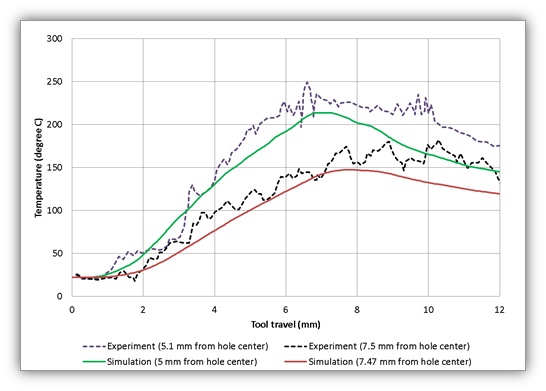

It is a clean, chip less hole making process that forms a bushing from thin workpieces that can increase the depth for threading and the clamp load capability. It involves large work-material deformation, and high tool and workpiece temperatures. Simulation is necessary to understand the material flow, temperatures, stresses, and strains, which are difficult to measure experimentally. Isight can be used to evaluate the optimized value of the coefficient of friction for best match of the simulation results with experiment.

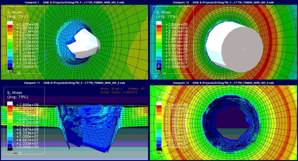

1. Friction Drilling Simulation
2. Friction Drilling: Simulation VIDEO

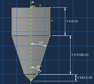

4. Rigid Tool Dimensions

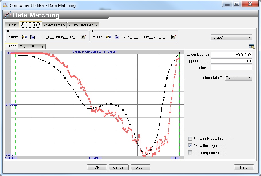

6. Isight Data Matching Component: Minimize the sum of absolute area difference between the simulation and target graphs

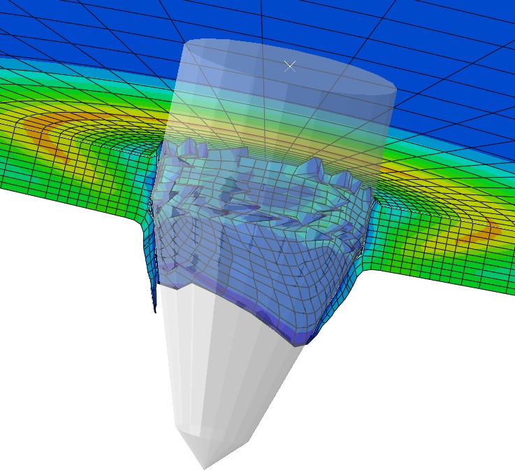

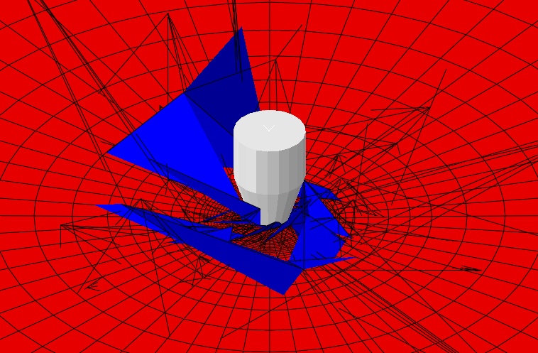

7. Elements deleted (blue – made visible here) by Abaqus as the tool penetrates the workpiece

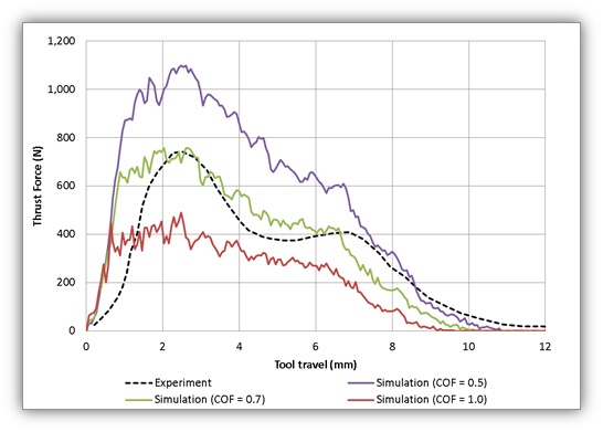

8. Simulation Result Comparison with Experiment: Thrust Force

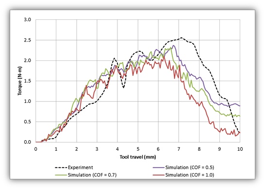

9. Simulation Result Comparison with Experiment: Torque
10. Simulation Result Comparison with Experiment: Torque
