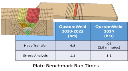

Improved Heat-Transfer Heat Integration
  • Up to 100x Speedup in Heat-Transfer Analysis
  • Torch can completely pass over elements in a single increment
  • Speedup applies to all Deposition Weld Torches
  • Speedup applies to all Beam Weld Torches

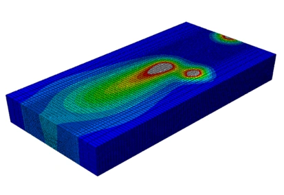

Overlapping Beam Welds
  • All beam torches can overlap one another
  • Heat-Transfer analysis speedups apply to overlapping beam welds

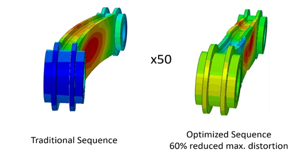

Possibility to Perform Weld Sequence Optimization
  • The speed-up with Heat-Transfer analysis makes it possible to perform weld sequence optimization
  • Example below shows minimization of distortion of a welded link performed in QustomWeld 2024-HF3-Beta1
  • Optimization sequence courtesy WSO (Weld Sequence Optimization) developed by Manufai
