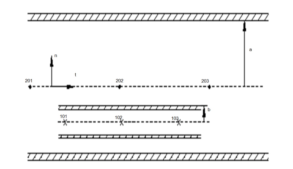

Apply ITT elements to the inner (smaller diameter) pipe:
Use ITT21 elements with two-dimensional beam, pipe, or truss elements. Use ITT31 elements with three-dimensional beam, pipe, or truss elements. Each of these elements is defined by a single node which is attached to the inner pipe.
Input File Usage:
*ELEMENT, TYPE=ITT31, ELSET=TUBE
1001, 101
1002, 102
1003, 103

Apply the slideline to the outer (larger diameter) pipe:
In the case of internal tube-to-tube contact, the slide line can be placed on the inner tube or the outer tube. Generally the slide line should be associated with the outer tube; however, if the inner tube is stiffer than the outer tube, the slide line should be attached to the inner tube.
Input File Usage:
*SLIDELINE, ELSET=TUBE, TYPE=LINEAR
201, 202, 203
Set TYPE=LINEAR to define a slide line made up of linear segments. This parameter should be used when first-order pipe or beam elements make up the model. Set TYPE=PARABOLIC to define a slide line made up of parabolic segments. This parameter should be used when second-order elements make up the model. In this case the slide line should consist of an odd number of nodes, where the odd nodes on the slide line are associated with the ends of parabolic segments.

Ensure a continuous slide line and check the radial clearance:
You specify the nodes that make up the slide line, and these must be in a sequence that defines a continuous slide line, i.e. the node list must follow a continuous sequence from one end of the pipe to the other.
You define the radial clearance between the pipes. Give a positive value to model contact between two pipes when one pipe (the one with the tube-to-tube contact elements) lies inside of the other pipe. The value given is the difference between the inner radius of the outer pipe and the outer radius of the inner pipe.
Input File Usage:
*INTERFACE, ELSET=TUBE
a – b (radial clearance)
You can model external tube-to-tube contact by specifying a negative value for the radial clearance. The magnitude of the value must be the sum of the outer radii of the two pipes
