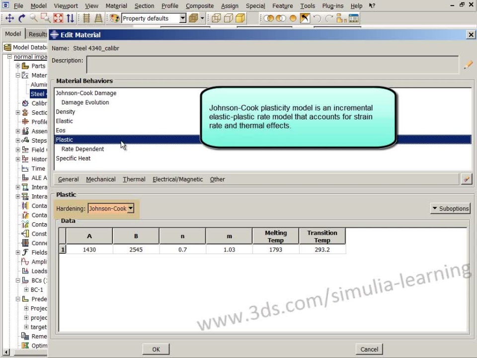

     -- Material Behavior (1:30-2:30)
        --- volumetric: EOS model (2:30-2:47)
        --- deviatoric: Johnson-Cook plasticity model (2:47-3:17)
