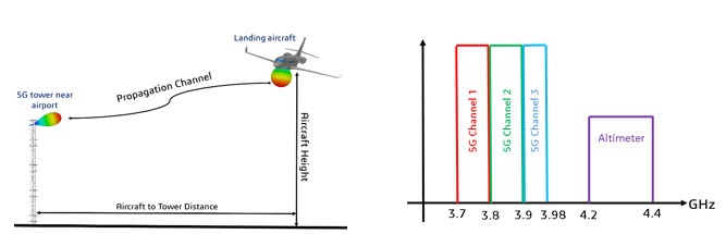

In the case of 5G interference with aircraft altimeter, we are more in the first scenario. The 5G C-band is between 3.7 and 3.98 GHz, which is only 220 MHz away from the altimeter’s operating frequency, which increases the risk of interference especially when the emitter and the receiver are physically close to each other. This is why the interference problem is the most dangerous during the approach and landing of the aircraft, where the altitude of the aircraft above the ground is very crucial. Figure 1.a shows a scenario where the landing aircraft is doing a roll maneuver in the vicinity of a 5G tower (The distance is a function of the horizontal distance between the 5G tower and the aircraft, and the height of the aircraft over the ground).
So how is the transceiver’s spectrum defined? The answer is given in Figure 1.b, where the 5G-C band [3.7 – 3.98] GHz is divided into 3 sub-bands. The current one that is occupied by Verizon has a width of 100 MHz (2). The other ones will be deployed in the near future, where one also has a width of 100 MHz and the last one is 80 MHz wide, which leaves a guard band of 220 MHz between the 5G band and the altimeter band. In fact, each of these 3 bands is divided into smaller 20-MHz-wide bands. This guard band is too small to let the harmonics of the 5G emitter interfere with the altimeter. Thus, the interference is most likely due to the spurious emitted power from the 5G antenna. This will be checked in the next section.
Figure 1. (a) Scenario of aircraft landing and (b) Spectrum of 5G emitter and altimeter transceivers

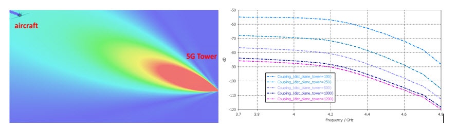

Figure 2.a shows an example of the power density plot that is emitted from the 5G antenna toward the aircraft. The simulation is carried out for several horizontal distances (between 100 and 1200 meters) to see how it influences the interference. The heights of the aircraft and the 5G towers are fixed at 100 meters and 30 meters, respectively. Figure 2.b shows the coupling between the 5G antenna and the altimeters for several distances. Naturally, the coupling decreases when the distance increases.
Figure 2. (a) Emitted Power density from the 5G antenna (b) Coupling between the antennas

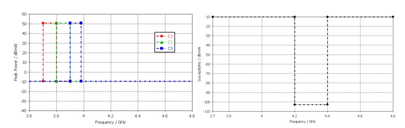

The idea now is to incorporate the coupling parameters in interference calculation. This can easily be done by using the interference task of SIMULIA CST Studio Suite. In addition to the coupling, we need to define the radio parameters for the 5G and the altimeter transceivers. For the emitter (5G) we should specify the number of channels (3) and their width, the emitted power or the PSD (Power Spectrum Density) and the spurious power. The receiver is also specified by the number of channels (1) and their width as well as their sensitivity. The RTCA (Radio Technical Commission for Aeronautics) published in their paper N°274-20/PMC-2073 some numbers regarding the altimeters sensitivity and the emitted power of the 5G antenna (3).
The figures below show the radios used. For the 5G emission, we have considered an urban mast where the antenna has an output peak EIRP (Effective Isotropic Radiated Power) of 70 dBm (or 50 dBm of peak power since the 5G antenna gain is around 20 dBs), with spurious emissions of -20 dBm, leading to a PSD of 50 dBm/MHz. As for the altimeter, we have chosen the properties that suits all the FMCW (Frequency-Modulated Continuous Wave) models, where the protection criterion concerns false altitude information, where the sensitivity is equal to -103 dBm. The altimeter’s saturation is set to -10 dBm.
Figure 3. Radio definition for (a) 5G antenna (b) altimeter​​​​​​​

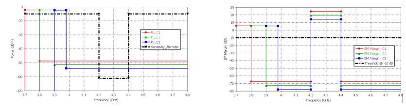

As an example, we will show the results obtained for a horizontal distance of 100 meters between the 5G tower and the aircraft. The figure to the left shows the received power at the altimeter, while the one to the right shows the EMI margins, both in-band and out-of-band. We can see that there is clearly interference with a high EMI margin, in-band and out-of-band. Clearly, the in-band margins are due to the spurious emission of the 5G antenna.
Figure 4. (a) Received power at altimeter, (b) EMI margins
We can clearly see that for a distance of 100 meters, we have high values of EM margins (all positive) and thus high interference. As a reminder, the interference threshold is set to -10 dB, which means that if the margin is lower than -10 dB we consider no interference. If the margin is between -10 and 0 dB, we consider that the risk of interference is high. Finally, the interference is certain if the margin is higher than 0 dB. These results can be visually interpreted from the violation matrix, given as an output. The colors Green, Yellow and Red tell us in which situation we are, respectively.

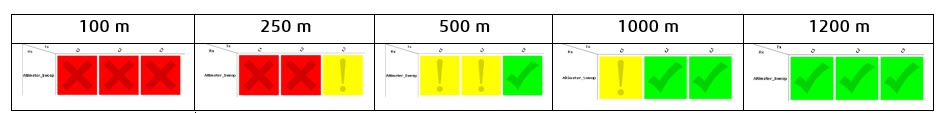

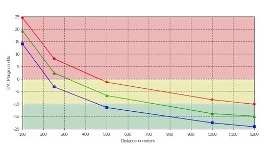

Since the coupling decreases when the distance gets bigger, the interference gets lower too. The following table shows the violation matrix for different distance scenarios, varying between 100 and 1200 meters. When the distance gets bigger, we tend toward a complete absence of interference. The corresponding margins for each 5G channel, as a function of the distance, are given in Figure 5.
Figure 5. Violation Matrices for different distances between the 5G tower and the aircraft
EMI Margin Vs. Distance with visualization of the danger zone (red), the risky zone (yellow) and the cleared zone (green)
The previous figure shows clearly that the simplest solution to avoid interference is to avoid deploying a 5G tower near the airport, since increasing the distance reduces the interference. However, this is not always possible – what if the tower that will host the 5G antenna is already deployed within a close range of the airport? The solution lies in adding filters within the transmission chain of both systems with a high out-of-band rejection. The figure to the left below shows the resulting coupling after adding the filters, compared to the original one for a distance of 100 meters. On the right, we can see that the filters help reduce the interference drastically, with margins lower than -10 dB.
