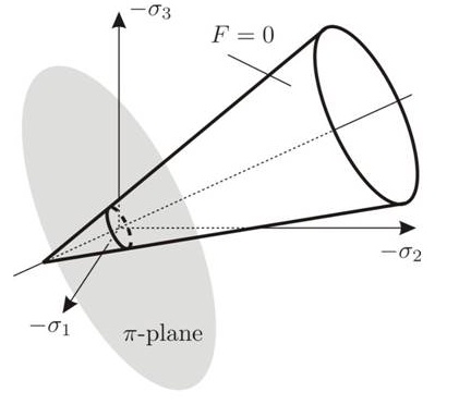

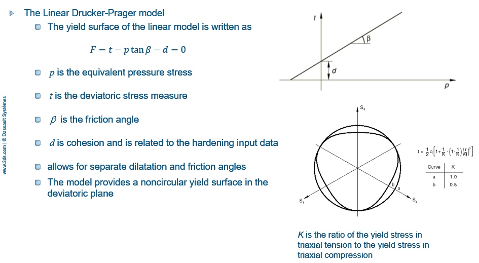

This conversation is limited to linear DP (LDP).   Also limited in scope to the example of polymers/plastics.  The LDP model has a conical shape of the yield surface and the parameter beta, friction angle, controls the cone angle.
If beta=0, this becomes the Mises cylinder.   The bigger beta gets, the bigger the difference between the compressive yield and tensile yield.

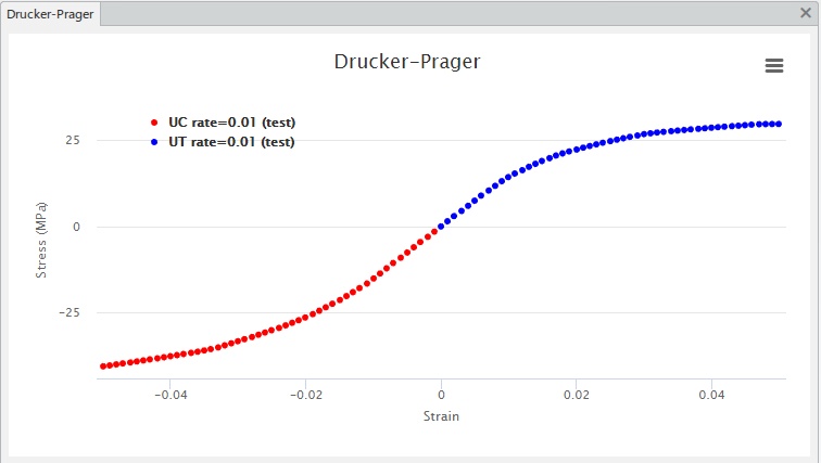

For polymers it is common to test in uniaxial tension and uniaxial compression.
It is also common to set the stress ratio, K=1, meaning the shape is circular in the deviatoric plane (PI plane).
It is also common to set the Dilation angle to 0.0  (no change in material volume while yielding).

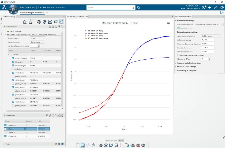

The video below uses the attached test data and calibrates a rate-independent Drucker-Prager material model. This video was created using a beta version of what will be 2020x FD04.

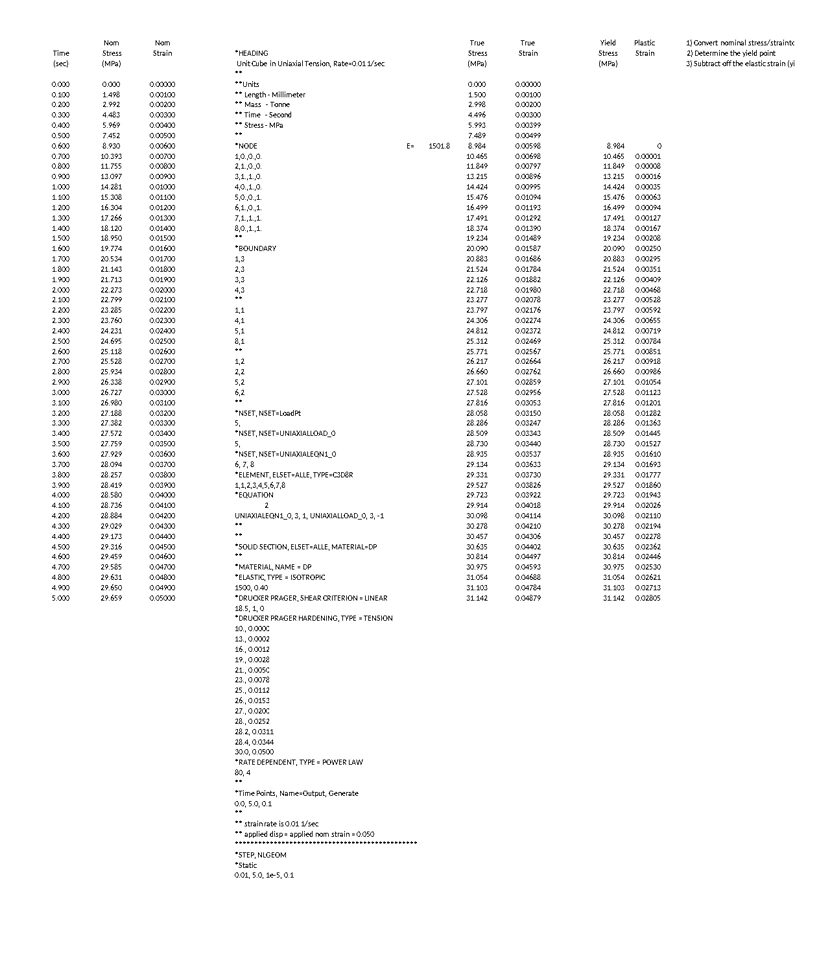

The Excel file attached to this post contains synthetic test data for uniaxial tension and uniaxial compression at a slow rate (rate=0.01).  Plus there are additional data sets for uniaxial tension at a rate = 1 and rate=10.  These additional data sets can be used to calibrate a Drucker-Prager rate-sensitive material model.
The Excel file also contains the Abaqus model file that was used to produce each set of data.
