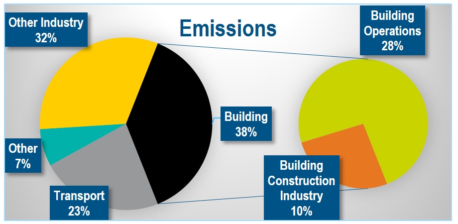

The building industry is the single largest energy consumer and CO2 emitter; not to say that transport is irrelevant, but yes, it is more than transport. In 2020, the UN Global status report for buildings and construction found that the building industry was responsible for 35% or energy use, and 38% of emissions. In 2021, the numbers were just as bad, with building exploitation (which means everything happening after construction) accounting for 30% of the energy use across industries. Looking a little further back, the trend of the building industry, in its efforts to meet the 2015 Climate Targets set out in Paris, has been appalling: we have been moving in the wrong direction, further away from our 2050 goal. The situation is so dire that Architecture 2030 claims that “We must eliminate all CO2 emissions from the built environment by 2040 to meet the 1.5o Climate Targets.”, at least for new builds.
Figure 1, Emissions per Industry in 2019, UN Global status report for buildings and construction

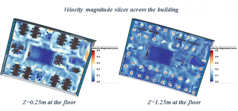

Figure 4, Velocity Magnitude from the CFD Simulation of an Office

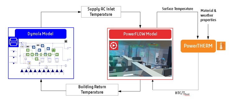

Although system modeling provides essential information for the initial layout and sizing, the comfort metrics, and detailed flow behavior in zones of high-temperature gradients, is not always well captured. In this paper, we replaced the system model representation of the building rooms with a 3D Computational Fluid Dynamics (CFD) simulation, coupled to the system representation of the HVAC. This approach provides us with very detailed information about the comfort of individual occupants during the hottest day of the year. The results obtained here contradict the 1D conclusions in some cases, benefiting from advanced comfort modeling and flow simulation. The design is then modified based on simulation predictions by installing expensive reflective glazing only in the required areas, improving comfort but keeping operating cost and construction costs low. Similarly, the 3D results indicate that certain areas exhibit a surplus of cold airflow. Excess vents are then moved to other rooms where airflow was lacking, such as the conference room in the paper, thus improving comfort without any impact on energy consumption. Interactive results are available here.
Figure 6, Coupled 3D CFD (for the room) and System Modelling (for the HVAC) Approach

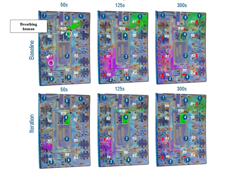

Improving thermal comfort and minimizing energy efficiency is one thing, but any changes in modern buildings are expected to also improve Indoor Air Quality. In this paper, the changes applied to the HVAC system are reassessed in a contaminant outbreak scenario. Two contaminated office occupants emit particles whose trajectories and deposition patterns are simulated with CFD. These types of simulations require accurate modeling of the detailed turbulent flow, including full simulation of all thermal conduction, convection, and radiation effects, as done in the paper. It is shown that although the new HVAC layout improves comfort at equal energy cost, it also generates flow structures which prevent particles from reaching HVAC outlets: up to 90% fewer particles are extracted from the building by the HVAC.
Figure 7, Simulation of the Deposition and Propagation of Contaminated Particles

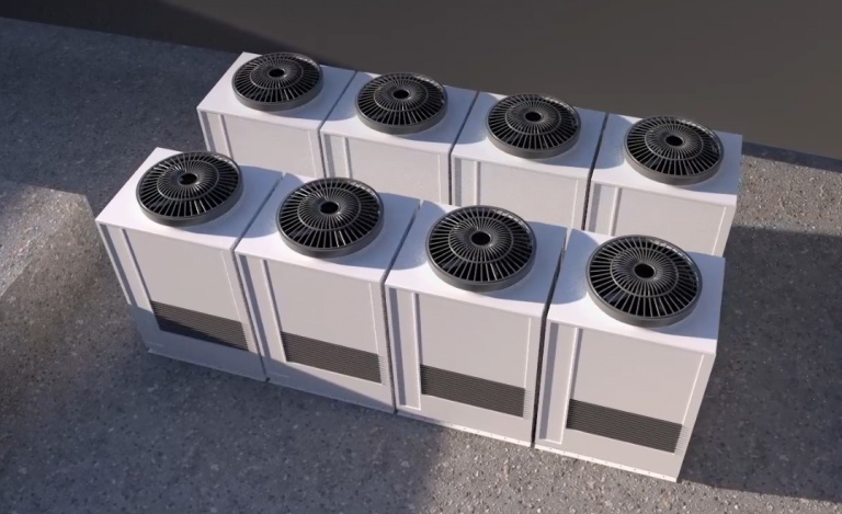

It’s clear that simulation can help for the installation of the HVAC. However, the same technologies can also be used when designing HVAC components, to ensure that the overall system performs effectively. This is particularly important when considering the design of the axial fan of a heat tower. As we will discuss in a future blog post, combined system modeling and 3D simulation allow manufacturers to optimize Seasonal Energy Efficiency Ratio and noise, simultaneously.
Figure 8, Cooling Towers
