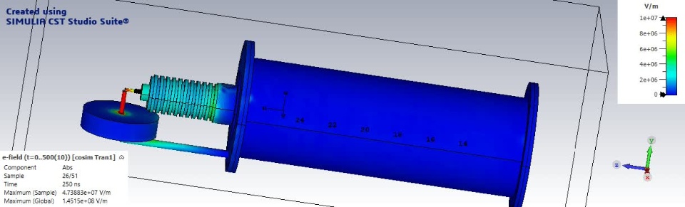

In this simulation a concrete rock was studied under the influence of nano second High Voltage Generator. The simulation has been done in 3d Electromagnetic software (SIMULIA CST Studio) using Field Circuit Co Simulation approach. The details of key parameters are:
Pulsed Power Generator: 12 Stage Marx, 300 KV, 30ns
Rock: Concrete, 40 years old (Breaks when Electric Field exceeds 10 KV/mm).
Voltage waveform:
https://lnkd.in/eCf33anZ
