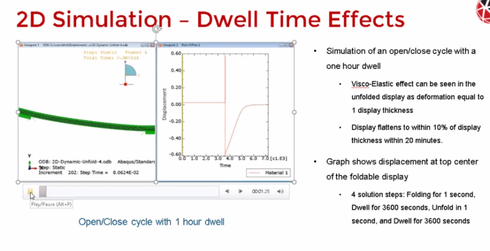

An important consideration with foldable screens is the assessment of the time dependent material properties of the OCAs, causing dwell time effects. This is when the phone is left in a certain position for an extended period of time.
Figure 2: Simulation of an open/close cycle with a one hour dwell.
OCAs have two different types of unique material properties that must be considered. The first are hyper-elastic materials, characteristic of incompressible materials, such as rubbers. These need to be modeled to take account of large strains that the OCAs experience during a full bend. The second is viscoelastic materials. Here the materials deform not truly, linear elastically, but in a viscous manner when the screen is folded. This property is exhibited when a smartphone screen stays closed overnight and does not return to its full flatness immediately upon opening. A dip or a trough in the fold of the screen is created that flattens over time. In simulations the time range was found to be anywhere from 20 min to over an hour and is highly dependent on the type of viscoelastic material used.

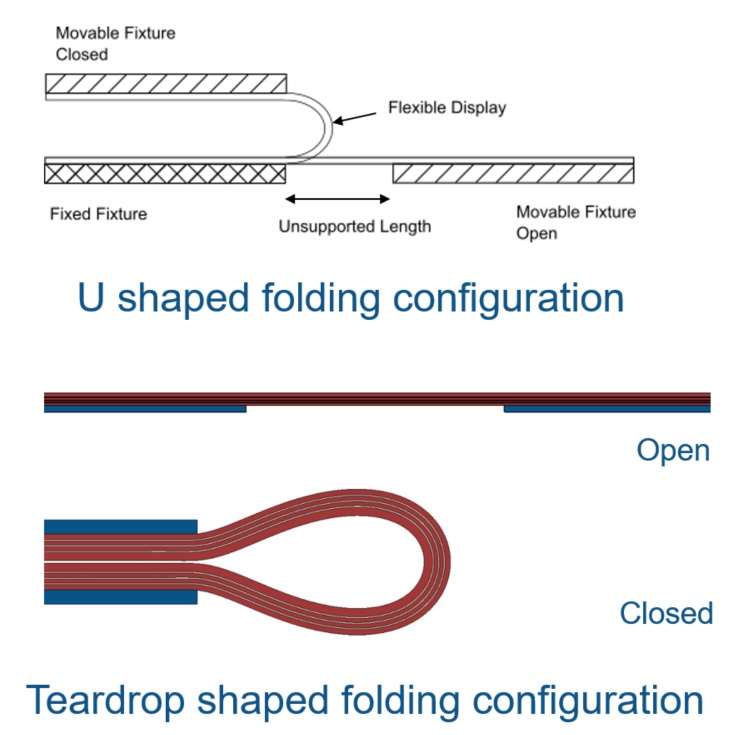

In addition to adhesives, the shape of the foldable screen hinge must be considered. The initial designs for many foldable screens were standard U shapes with parallel screens. This created a single curvature, which is used in testing to obtain material properties. The basic curve means stress predictions are straightforward. The problem with the U shape is that it creates a significant gap between the screens, which is undesirable in a modern device where space is at a premium and device thickness and bulk is an important deciding factor for consumers.
​​​​​​​Figure 3: Teardrop shaped folding configuration.
A solution is to use a more complex double curvature such as a teardrop shape, so that when folded, the two screens are effectively touching, with only a small gap between them. In this scenario, the overall device is much thinner with the only wasted space being inside the teardrop itself. This type of structure has a much more complex closing mechanism with potentially high shear stresses between layers that can cause delamination. Simulation in both 2D and 3D helps to create the optimal combination of shape, structure and materials to ensure that the screen can withstand thousands of operating cycles.
