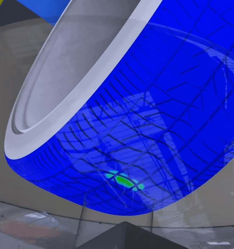

As we have a full virtual twin of the tire assembly in conjunction with the installed antenna, we will perform the analysis at the worst loading case, which is when the tire rotation places the antenna at the bottom of the tire with maximum expected deformation, using Tire Analysis Engineer Role on the 3DEXPERIENCE platform.
The antenna, which is designed and optimized as a flat structure, is initially adhered to the un-deformed inner liner of the tire. Then we can apply the deformation vector to the full tire assembly as well as the antenna to generate the fully deformed device under test.

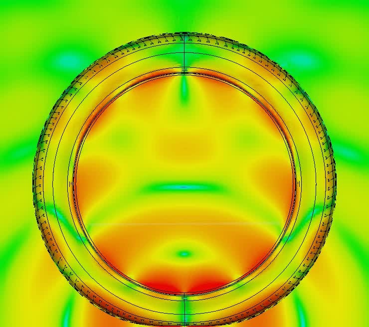

Due to the nature of the problem where we have a deformed thin panel antenna on a relatively large structure, we choose to use our market leading transmission line matrix (TLM) solver. Due to its use of an octree mesh, we can easily apply a very fine mesh in the proximity of the antenna, where this resolution is required to accurately mesh the geometry, while automatically reducing the mesh fidelity the further away from the antenna we get. The resulting mesh has 25 million cells and in order to efficiently run the simulation we make full use of cloud computing and GPU acceleration, which our time domain solvers can utilize to significantly reduce simulation times.
CST Studio Suite’s powerful post processing engine allows us to generate all manner of outputs that might be relevant. In this case, beyond the normal antenna related KPI such as scattering parameters and farfield directivity, we might be interested in the read-distance at which the tire can still successfully communicate with a handheld reading device or the aforementioned reading stations. This can easily be set up and visualized accordingly.

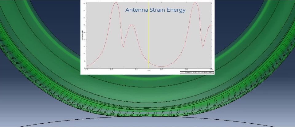

Finally a word on fatigue. As previously discussed the tire assembly will be under load for a considerable amount of time. The filigree structures of the meander antenna are particularly susceptible to fatigue issues. Every pot hole that is hit has the potential to cause a fracture in the metal structure that is just going to grow over time until the antenna finally breaks and no longer functions. Fatigue analysis can help predict how many cycles and how long a given structure can be expected to survive before failure. This would be an important metric by which tire replacement needs to be scheduled. Detailed telemetry information will help the OEM to make informed decisions on a case by case basis for each tire.
