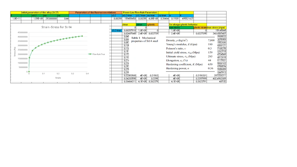

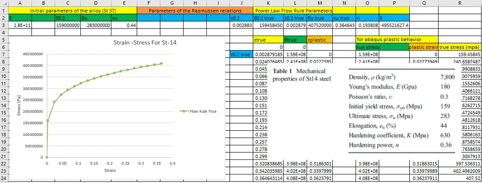

I have been working on simulations involving ST14 steel, and I’m sharing an Excel file that includes the strain-stress curve along with important material parameters for ST14 and St37 alloys. This data can be useful for those working on simulations requiring accurate material properties.
You can download the Excel file containing all the relevant data from below:
If you have suggestions on how to improve the material model or if you see any discrepancies in the data, please feel free to comment.
