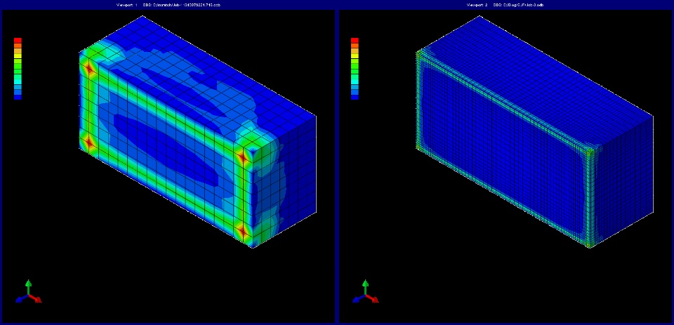

1) Discontinuities result plot in Abaqus (Preferred Approach):
In Abaqus Visualisation Module: Result -> Option -> Discontinuities Contour Plot.
The discontinuities plot displays the differences in field output values between adjacent elements. The Abaqus/CAE User’s Manual: 42.5.2 states:
“Discontinuities: For the display of discontinuities, the calculated invariants or components at nodes common to two or more elements are compared to determine the greatest difference, depending on the compatibility of contributing result regions and on options you select. Nodes associated with only one element and nodes receiving equivalent values from all contributing elements will show a value of zero in a plot of discontinuities.”
Further discussion in displaying the Discontinuity plots are found in the Abaqus/CAE User’s Manual 42.5.5: Displaying field output values or discontinuities.
Fig 1: Comparison of mesh refinement on pressure loaded surface for Mises Stress plot. Coarse Mesh -> Wide spread discontinuities, Finer mesh -> Smaller localised discontinuities.
