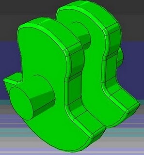

3.1.CREATING 3-D MODEL:

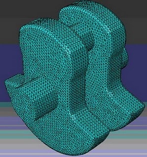

3.2.MESHING OF CRANKSHAFT:

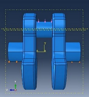

4.LOADS AND BOUNDARY CONDITIONS:
In this case the bending load is applied on the top portion of crank pin. The bottom portion of journal periphery is given Y & Z degrees of freedom fixed and X free for one side. Other side is given only Y degree of freedom fixed and X & Z free.
4.1.BENDING LOAD APPLIED ON TOP PORTION AND JOURNAL IS FIXED:

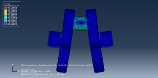

4.2. BENDING STRESS PLOT (1st Principle Stress):

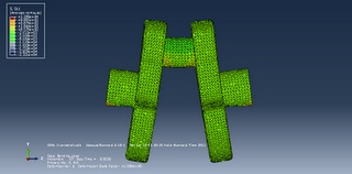

4.3. VON-MISES STRESSES DUE TO BENDING LOAD:
