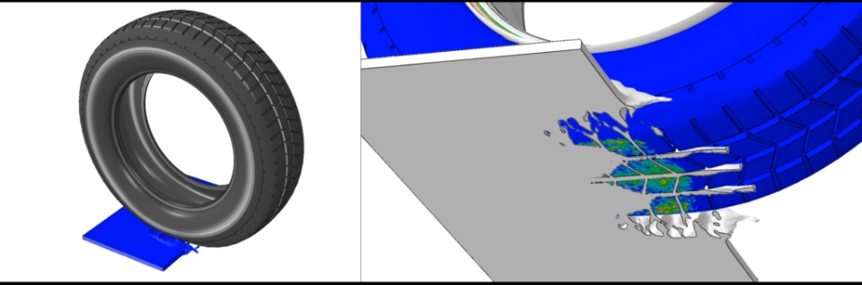

Simulation with Abaqus/Explicit of a tire running through water and contact of tire with the grown as the water moves into the threads. This type of simulation helps to improve tire tread design to reduce hydroplaning.

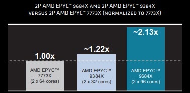

The AMD performance brief shows a 2P server powered by AMD EPYC 9684X (96-core) processors with AMD 3D V-Cache technology delivered a performance uplift of ~2.13x compared to a 2P server powered by prior-generation high core count 64-core AMD EPYC 7773X processors with AMD 3D V-Cache technology. Further, a 2P server powered by 32-core AMD EPYC 9384X processors outperformed a 2P server powered by the same previous high core count 64-core AMD EPYC 7773X processor with an uplift of ~1.22x. AMD 3D V-Cache technology delivers triple the L3 cache compared to same-generation processors. This large L3 cache enables helps improve performance by continuously feeding the processor with data without having to access main memory outside of the CPU, resulting in faster time-to-results.
