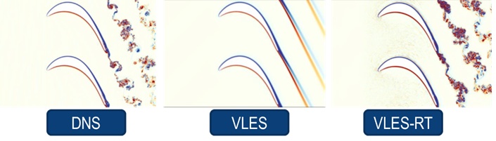

- The VLES turbulence model in the HS and TS solvers includes a laminar-turbulent transition model, leading to higher accuracy for high speed flows at low to moderate Reynold’s numbers, as well as at very fine resolution.

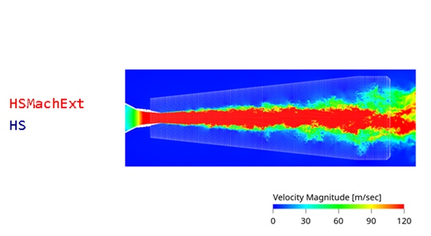

- With the “Mach Regime: High Subsonic with Extended Range” option, the Mach number range of the HS solver is extended beyond Mach 0.95 for flows with local flow speed slightly above Mach 1 (
Enhanced Turbulence Model with Laminar-Turbulent Transition (VLES-RT)
High Subsonic Solver with Extended Range above Mach 1 (no strong shocks)
