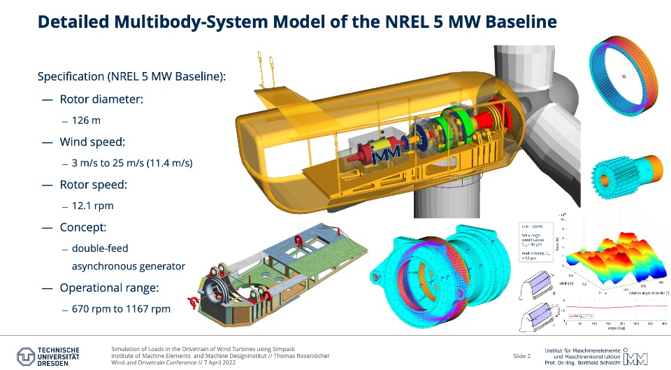

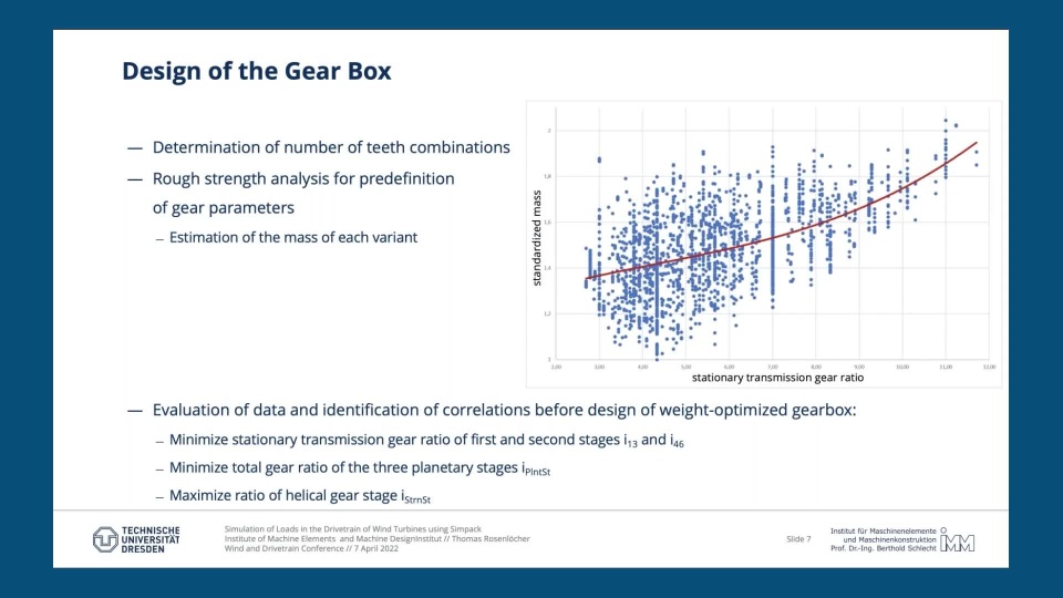

The extensive requirements for the reliable operation of wind turbines make the design and the dimensioning of wind turbine gearboxes an interdisciplinary challenge. In the meantime, the possibilities of the dynamic simulation are already in use in an early stage of the development process. The natural frequencies can be determined and compared to possible excitations through simulation models. The simulation of the operation of the wind turbine under different wind speeds allows the calculation of component loads as a basis for the further design process.
The presentation concentrates on the challenges of dimensioning and the design of gearboxes for wind turbines and the associated dynamic properties of the complete system on the example of NREL's 5 MW reference wind turbine. The available simulation model is used to determine the influence of the model's level of detail on the resulting loads for the bearings and the occurring load distribution in the gearing of the first planetary gear stage. The available results offer improved possibilities to design drivetrain components and understand dynamic effects during the operation.
