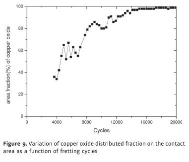

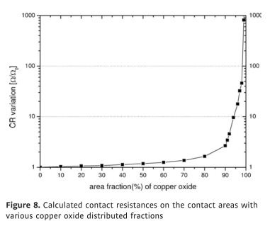

The contacts studied were made of copper with a tin coating.  The coating wore away quickly and after that the copper substrate began oxidizing and eventually its entire surface was oxidized.  The percentage of surface covered with copper oxide had a large effect on contact resistance as seen in the figure they published.  It appears not to have too detrimental of an effect until the oxidation covers 90 percent of the contact surface.  However, as seen from the modeling results below this happens around 12,000 cycles into the simulation.

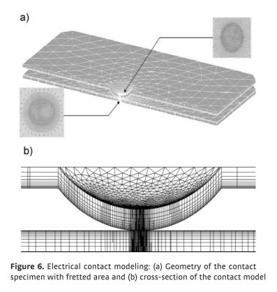

The fretting corrosion process was modeled using Abaqus in a three-dimensional simulation.  However, not many details of the simulation were given in the paper.  The copper oxide properties were assigned at random locations along the surface using a fortran program.
