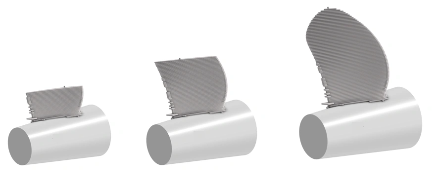

There are several distinct tasks in an AM propeller design cycle. These include 3D CAD design of the part itself, definition of the AM process, and simulation and analysis. These can all be linked together with a “digital thread” – an integrated workflow where data is shared between tasks and all stakeholders are working on a common digital model on a single source of truth.
Dassault Systèmes offers a digital thread for additive manufacturing on the 3DEXPERIENCE platform. A propeller or other part is initially created in a CAD tool. This can be done directly in the design software on the 3DEXPERIENCE platform, or by importing a design in a format like STL, commonly used for AM. This is prepared for simulation with the CATIA Digitized Shape Preparation app.
The AM process is then defined using the DELMIA Material Deposition Fabrication app. This slices the geometry into layers and sets up the path for the laser. The SIMULIA Additive Manufacturing Scenario app then uses this to model the AM process. Transient heat transfer analysis calculates heat inside the part as the laser beam moves. This is then coupled to a mechanical simulation and drives the calculation of the static residual stress within the part.
Throughout this process, there is a direct, traceable connection between each step. The input for each stage is the output of the previous stage, and important context is preserved. Users can be confident that the final result reflects the original process, and if quality issues are identified, the problems can be traced back up the digital thread to their original source.
