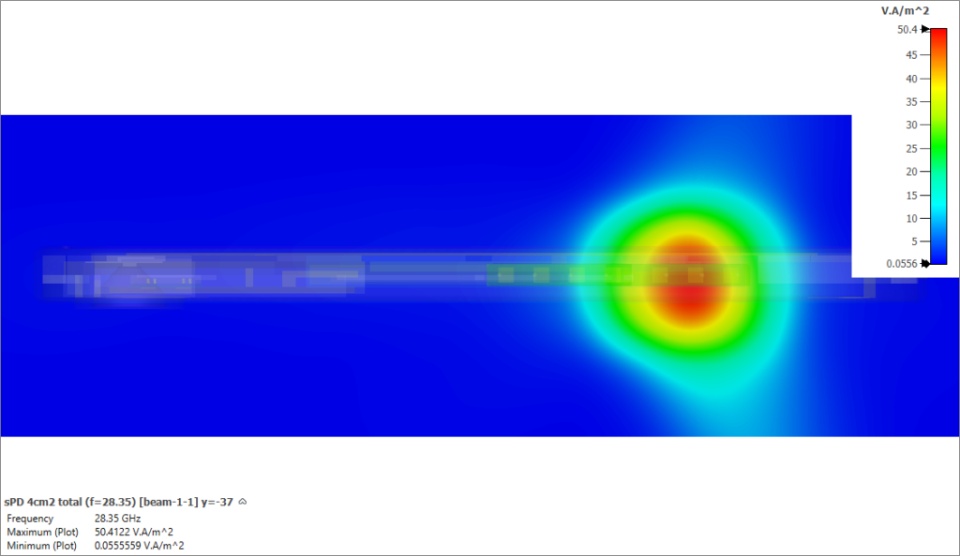

Simulated sPD on a plane perpendicular to the smartphone.

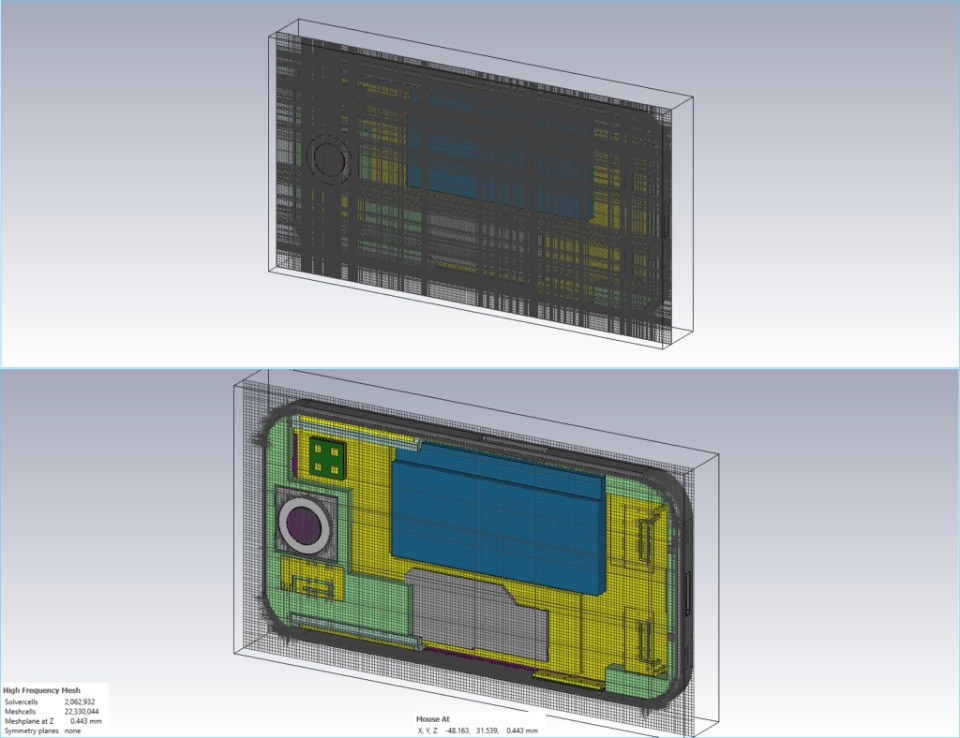

Because of the short wavelengths of mm-wave, 5G simulation often requires a very fine mesh with lots of mesh cells to represent the field behavior, and therefore needs a lot of computing power. In addition, many smartphones use a 5G transmit technology that assumes multiple antennas distributed across the device, meaning that the simulation needs to cover the entire device, not just the portion containing a single antenna. The Transmission Line Matrix (TLM) solver in CST Studio Suite is extremely memory efficient, and can tackle much larger simulations than other numerical methods.

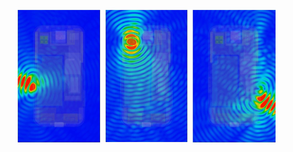

Nearfield plots for three different antennas on a smartphone.

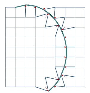

The TLM solver allows a very fine mesh to be used and adapted to fit complex geometry, while lumping together cells in open space, away from details of interest. The image below shows how mesh bleed can be reduced with lumping, and the best mesh resolution is used for each part of the model. This reduces the computational requirements of detailed electrically large, high-frequency simulation and means that CST Studio Suite is especially well suited to 5G certification. HPC options such as GPUs, cluster and cloud computing can accelerate simulations significantly to simulate the entire device with all antennas and components included.
In the test case shown below, TLM cell lumping was able to reduce mesh cell count on a high accuracy smartphone from 127 million cells to just 5 million. The entire model, considering all antenna ports and all frequencies, was solved in under two hours.
TLM mesh warping
Mesh for simulation of a demonstration 5G smartphone, before (top) and after (bottom) TLM mesh lumping

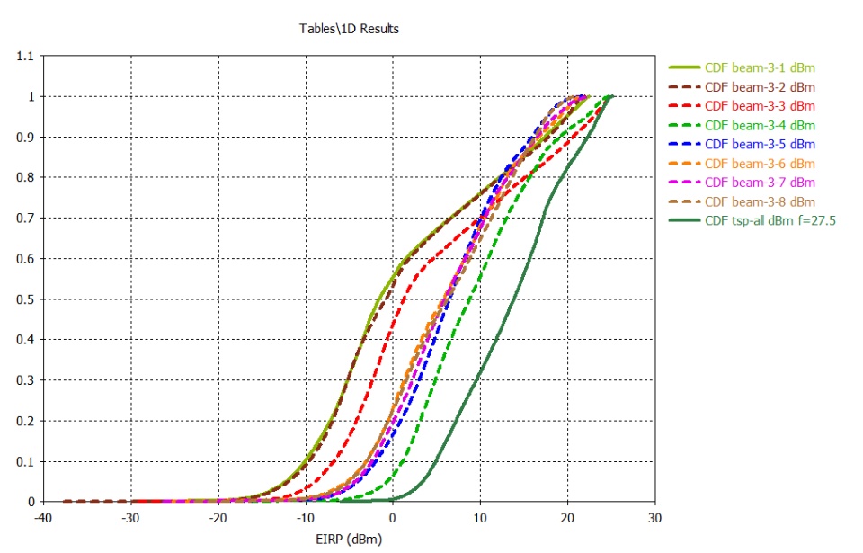

Simulated CDF vs EIRP, used for the antenna design
The 5G wizard automatically creates and executes post-processing templates that compute both antenna design KPIs such as the cumulative distribution function (CDF) vs equivalent isotropic radiated power (EIRP), and certification KPIs such as spatial power distribution (sPD). The worst-case scenario can be identified and the contribution is calculated by summing all the different beams. The simulated sPD can be compared to the limits specified in the regulations in order to determine whether the device passes or fails.
Once the worst-case sPD has been calculated, measurements can then be taken in a test lab. As long as the worst-case measurements offer a close agreement to the simulation results, the entire set of simulation results can generally be accepted. This offers a significant time saving, by drastically reducing the number of total measurements needed.
