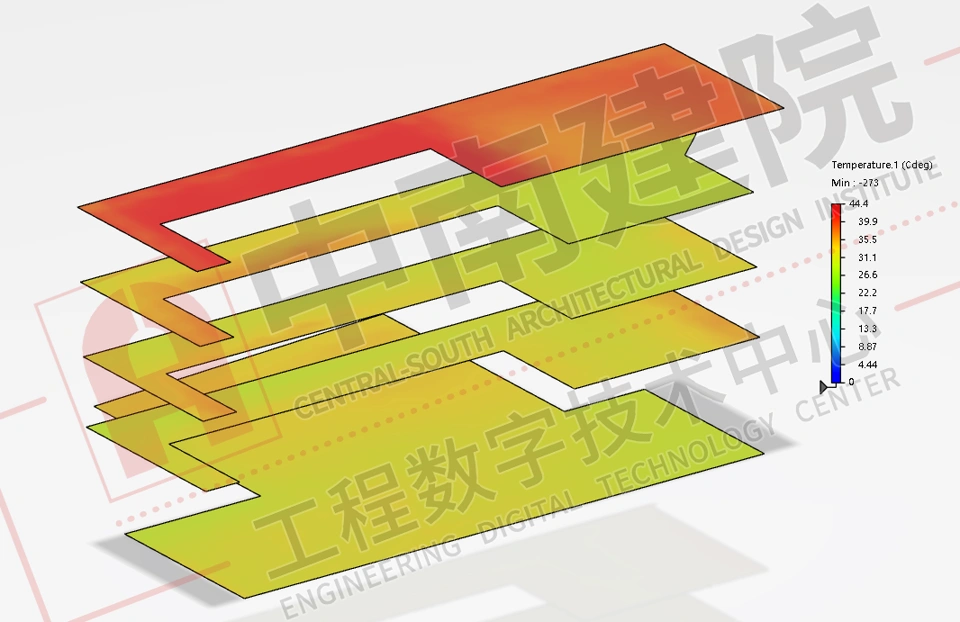

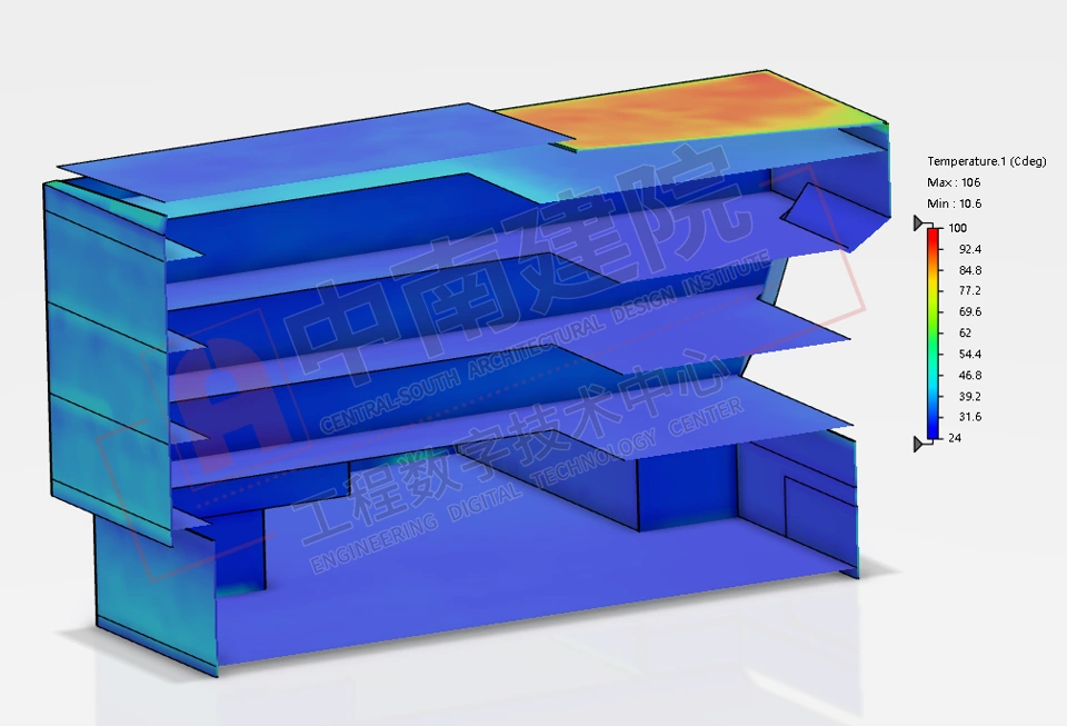

Project Introduction: A newly constructed public building project in China
Simulation Area: The atrium's large open space area within the project
Boundary Conditions:
  1. Thermal radiation from the atrium's glass roof.
  2. Natural ventilation openings from the second to third floors.
  3. Indoor human heat sources.
  4. Air-permeable gaps in the top roof.

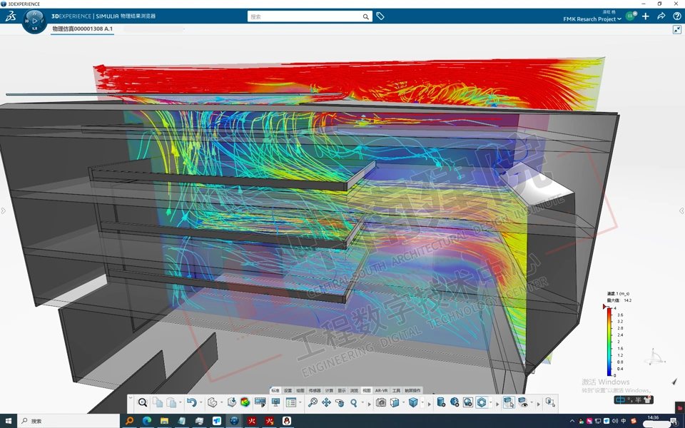

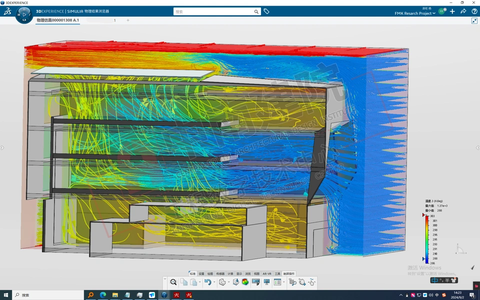

Simulation Objective: To assess indoor air movement and airflow organization patterns.
Stack Ventilation: Stack ventilation arises from the temperature difference between indoor and outdoor air, known as the "chimney effect." Due to this temperature difference, a density difference occurs, leading to a pressure gradient along the vertical direction of the building's walls. When indoor temperatures are higher than outdoor, the upper part of the building experiences higher pressure, while the lower part experiences lower pressure. Air enters through windows or doorways at the bottom and exits through skylights or light wells at the top.
