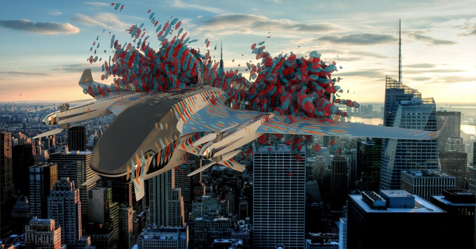

Balanced external loads in critical flight conditions must be known for structural sizing. In any given flight condition, the vehicle is subjected to aerodynamic loads, rotor forces, gravity and inertia loads. Thanks to the 3DEXPERIENCE platform, using the Fluid Dynamics application, the engineers had already set up a CFD model fully associated with design, to size the external surfaces and determine the aerodynamic loads of the conceptual eVTOL vehicle as a function of angle of attack, Mach number, etc. Rotor forces, balancing aerodynamics, inertia and gravity loads were then computed to ensure flight loads equilibrium. This external load database was used to feed the structural model of the eVTOL, which is fully associated with its CFD model. Finally, the engineers applied a combination of parametric and non-parametric structural optimization techniques to determine an optimized configuration and sizing for the conceptual vehicle.

By combining parametric and non-parametric optimization techniques, the engineers ensured that their design had the lightest possible structure that met requirements. The Fluid Dynamics application allowed them to generate aerodynamic loads, which depend on the external shape of the vehicle, by performing CFD simulations directly on the native geometry and to update the loads whenever the design itself was updated.
