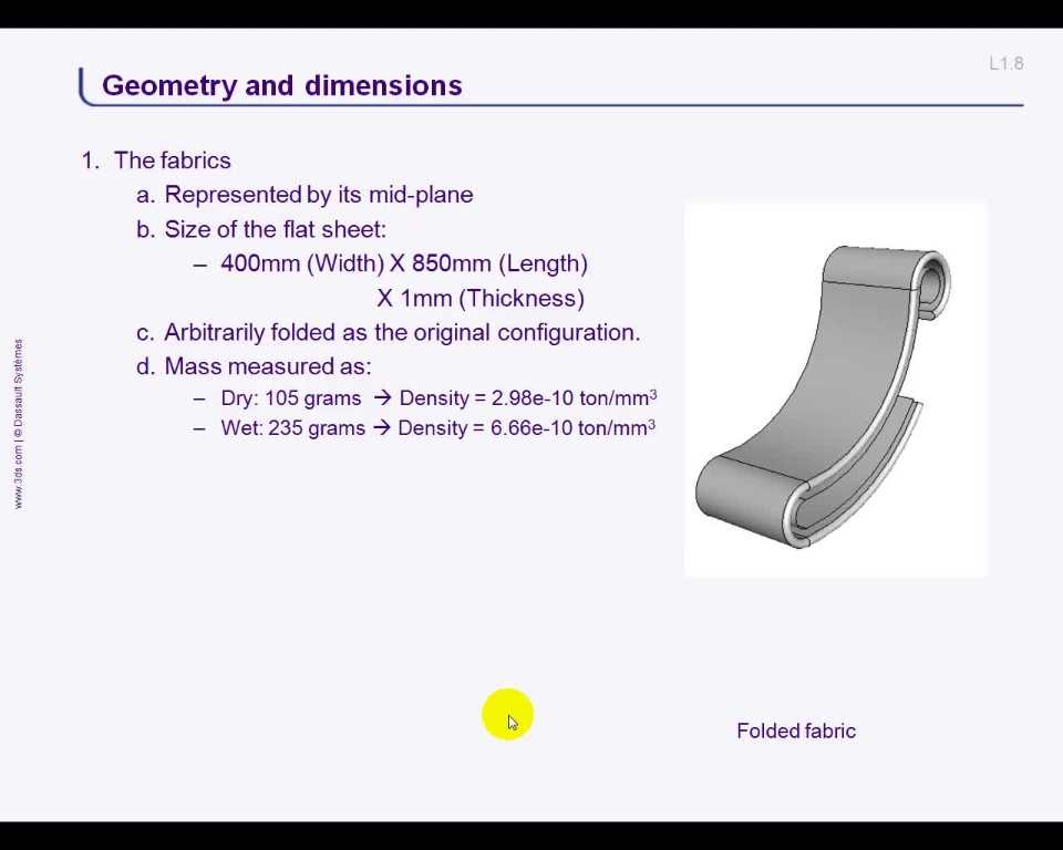

The geometry of a single piece fabric used in this demo is shown in the figure below as its initial configuration.
Folded fabric

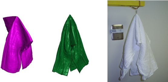

2) The material model was first confirmed with free falling of a piece of fabric before used to model the pieces used in simulating its motion in a tumbling drying / washing machine. Comparison between the real fabric and the simulated shape is shown below:
                                                  Stiffer fabric                     Softer fabric                            Real fabric

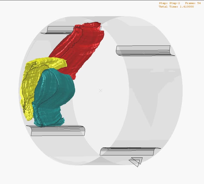

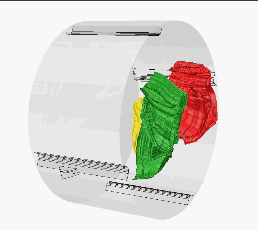

In this demo, the tumbling drying machine with 3 lifters is modeled using Abaqus/CAE. Shown below is the initial assembly with 3 pieces of fabrics included. General contact and friction are defined between the fabrics and the basket and among the fabrics themselves. The constant angular velocity of 2/3 cycles per second is applied to the basket.

  Typical tumbling pattern
