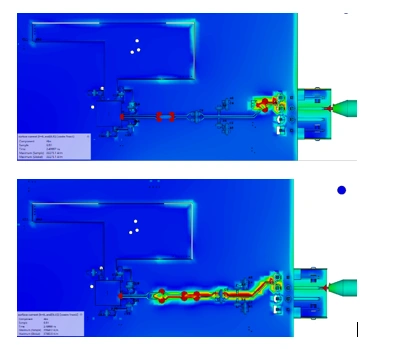

Simulation offers a faster alternative to testing. Unified modeling and simulation (MODSIM) makes it easy to turn CAD geometry data into a simulation-ready virtual prototype of the DUT and the test equipment set-up. An excitation at the tip of the virtual generator creates an ESD pulse, and the simulation calculates its propagation through the device. 3D field monitors can visualize the exact path of currents flowing through the device, and virtual field probes can be placed anywhere in the virtual space, including inside the device.

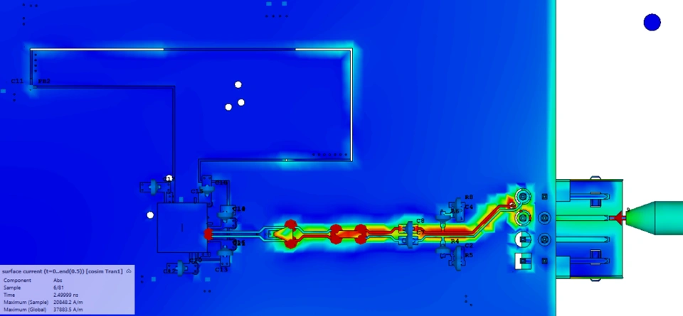

ESD simulation representing a test set-up as defined by ISO 10605.

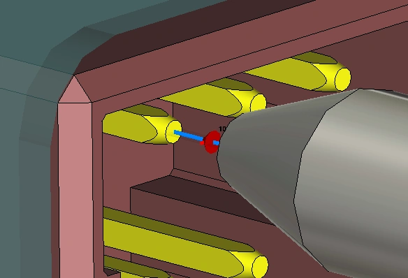

Both contact and air-gap ESD generators can be simulated. In the case of an air gap (in other words, where voltage breakdown in the air causes an arc, an electromagnetic simulation is first performed to calculate possible arc paths at different voltages using Paschen’s law, and to generate a SPICE model that represents the non-linear electromagnetic properties of the arc. This then forms the basis for the time domain simulation of the ESD pulse, with true transient co-simulation combining the SPICE circuit model with the 3D simulation model.
The simulation produces several ESD KPIs and a 3D visualization of electromagnetic fields and surface currents around the device. Using virtual probes, users can view voltages at any point in the structure throughout the duration of the pulse. Users can generate all the KPIs that a physical test would provide, and some that would be impossible to measure.
