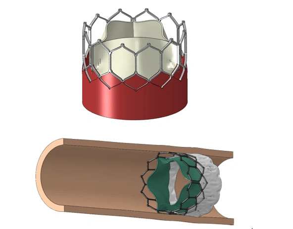

Figure 1: FEM Model of a Sapien-3 TAVI Device

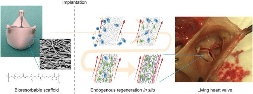

A: There is a new class of devices becoming available. Even the substitute devices, these TAVI devices, over time, deteriorate, lose performance, and must be replaced. What can you do if the patient has them longer than 10-15 years? The best solution would be if the function is restored through your tissue, if your body could help or could develop a solution, restoring the original function of the heart valve. Over the past 15 years, there’s been a new strategy developing that uses biodegradable synthetic material. Once it is placed into your body, it attracts certain types of cells that start to infiltrate it and start to produce new tissue, and at the same time, the synthetic material starts to biodegrade. This is a balanced process between synthetic tissue being degraded and resorbed over time and, likewise, at the same time, new tissue being generated. Theoretically, you could build in whatever geometry you would like to have, and your body could recreate new structures. This is a promising strategy but challenging. If it’s your tissue, there is no further risk that this will deteriorate because it’s a living organism.
Figure 2: In situ heart valve tissue engineering using a bioresorbable elastomeric implant – From material design to 12 months follow-up in sheep

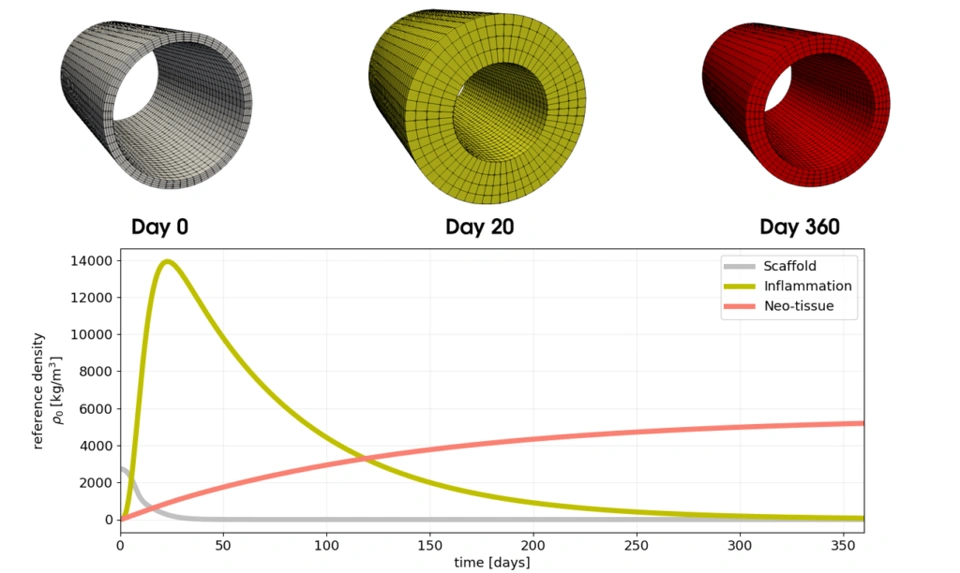

Figure 3: Conceptual Modelling approach to account for scaffold degradation and neo-tissue growth (KU-Leuven | EMSE)

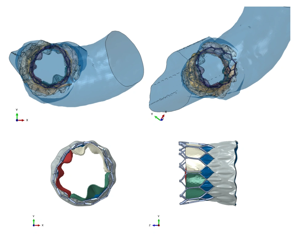

A: Our main goal in this project is to develop two platforms. A platform is effectively a computer model that can be used to simulate how these devices could evolve within a given patient. We have two classes of devices for which we want to develop these platforms. And within these two platforms, we need to ensure that we have the right material models developed that can simulate the biological process of degradation and restoration. We are simulating a biological process. That material is changing: it is growing, and it’s changing its dimensions and its mechanical properties. Another group is the patient models, where we have a group that is collecting true patient data through a clinical center and using this data to generate patient-specific models from real patients who are undergoing classic TAVI treatments.
Figure 4: FEM Model of the TAVI device implanted into a Patient-Specific Model of the left ventricle and aortic arch (4RealSim | UniPa)

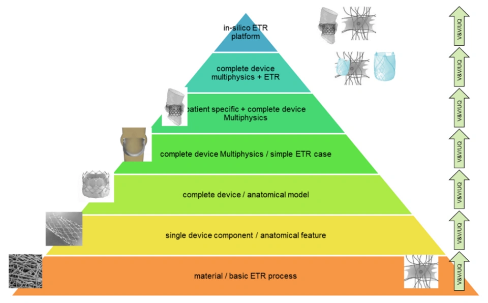

Figure 5: Hierarchical VVUQ concept to establish credibility in the SimInSitu Project
A key objective of the SimInSitu project besides developing advanced simulation tools for complex systems, is establishing the credibility of these models as well. This is generally done through VVUQ, which stands for Verification, Validation & Uncertainty Quantification, and which is a structured approach to make sure that the predictions done with the computer model are trustworthy. Our experience in the VVUQ domain increased tremendously, which we discussed and shared with other industries, like aerospace and automotive. We realized there is a lack of deep understanding and experience in using these methods as part of your daily job in a company or research institute. We at 4RealSim are trying to improve this situation by offering also dedicated training.
