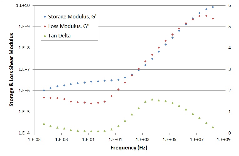

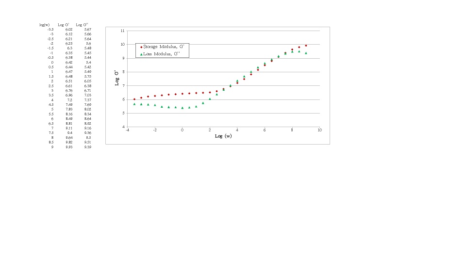

Shear Moduli Master Curve for Polyisobutylene
In the 3rd edition of Ferry's Viscoelastic Properties of Polymers, this data is given in Table 3, Appendix D on page 606.  On page 604 it tells us that the units are dynes/cm^2.

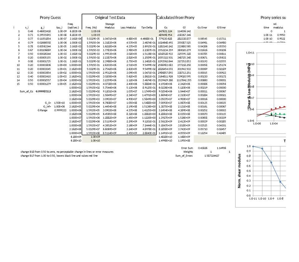

More to come..  I will insert here a calibration to this data using our 3DX calibration app...
An Excel file containing the data:
An Excel file showing a Prony series material model calibration to the test data:
