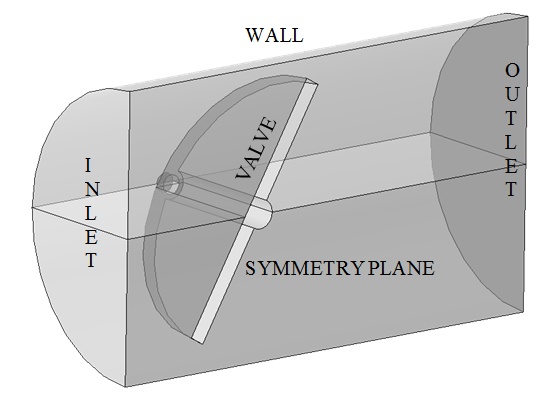

The half-symmatry Abaqus/CFD model representing the fluid domain is shown in Figure 1.  The length of the valve itself is 0.042m.  The computational model dimensions have been chosen to mimic the pipe that the valve operates in. The diameter of the pipe is 0.045m and the length is 0.075m. The model consists of 532379 tetrahedral fluid elements (FC3D4). The simulation is run for a total simulation time of 0.3 s. The CFD model includes a surface definition representing the region of the fluid which interacts with the cylinder surface.  It will be used to define the co-simulation interaction with the Abaqus/Standard model.
Figure 1. CFD model
Material Properties
The fluid is modeled as an incompressible Newtonian fluid.  The properties of the fluid are chosen to achieve a flow Reynolds number of 4200 based on valves’s diameter and the inlet velocity.  The fluid density is chosen to be 1000 kg/m3 and viscosity is 0.001 Pa∙sec.
Flow Solver
The Abaqus/CFD procedure invokes a transient incompressible turbulent flow analysis.  Automatic time incrementation based on a fixed Courant-Freidrichs-Lewy (CFL) condition is used. The Spalart-Allmaras turbulence model is chosen to simulate turbulence.
The following ‘flow’ boundary conditions are applied to the fluid.
  1. Inlet:  An inlet velocity of 0.1 m/sec is applied
  2. Outlet:  An outlet boundary condition is specified with the fluid pressure set to zero.
  3. Pipe Wall:  A no-slip/no-penetration wall boundary condition is applied at the pipe wall. All velocity components are set equal to zero.
  4. Symmetry:  The velocity normal to the symmetry planes (Vy) is assumed to be zero to constrain the out-of-plane flow.
The following ‘mesh’ boundary conditions are applied to the fluid.
  1. Inlet:  Define a ‘Mechanical’ category boundary condition of type ‘Displacement/Rotation’ and constrain mesh motion in the U3 direction by setting U3=0.
  2. Outlet:  Constrain mesh motion in the U3 direction by setting U3=0.
  3. Pipe Wall:  Constrain all 3 components of mesh motion to zero: U1=U2=U3=0
  4. Symmetry:  Constrain mesh motion in the U2 direction by setting U2=0.

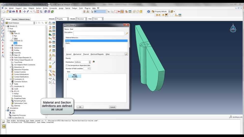

Create an interaction of type Fluid-Structure Co-simulation boundary and choose the valve surface as the surface to which the interaction will be applied.
Structure Model

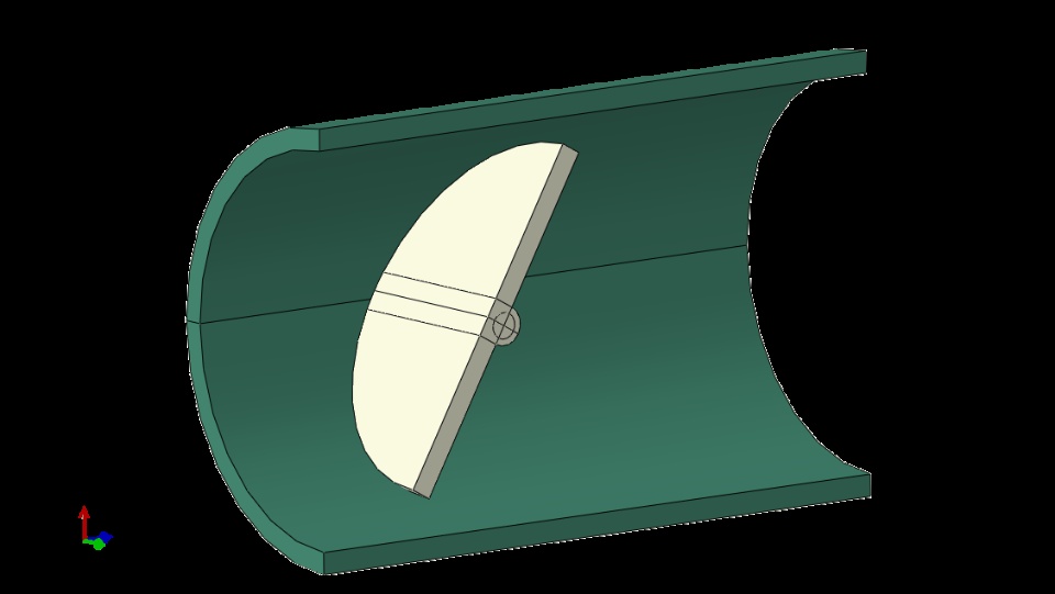

The Abaqus/Standard model of the pipe-valve assembly is shown in Figure 1.
Figure 2 Structural model for Pipe-Valve assembly
The structural model in Abaqus/Standard is comprised of first-order hexahedral stress/displacement elements (C3D8R).  A total of 35000 elements are used to define the assembly.  The valve’s surface interacts with the surrounding fluid and hence it is used to define the co-simulation interaction with the Abaqus/CFD model.
Material Properties
A density of 7800 kg/m3, Young’s modulus of 200 GPa, and Poisson’s ratio of 0.3 are used to define the cylinder’s material properties.
Constraints
A rigid-body constraint has been applied to the pipe to model the pipe as a rigid body. A coupling constraint is applied to the valve to rotate the valve as a rigid body based on a reference point
Structure Solver
The Abaqus/Standard procedure invokes an implicit dynamic analysis step. An initial time increment of 0.0001 s is used; however, the time increment can change depending on whether the structural or CFD model is dictating the time increment size.  The built-in time incrementation strategy is used where the co-simulation coupling time is chosen as the minimum of the time increments dictated by the structural and CFD models.  The total simulation time is chosen to be 0.3 s
Boundary Conditions
The following boundary conditions are applied to the structure assembly
  1. Pipe: Constrain all degrees of freedom of the pipe referent point
  2. Valve: Apply an angular velocity component to the valve reference point in the y-direction of UR2=-0.0873 and constrain all other degrees of freedom.
  3. Create an interaction of type Fluid-Structure Co-simulation boundary and choose the valve surface as the surface to which the interaction will be applied

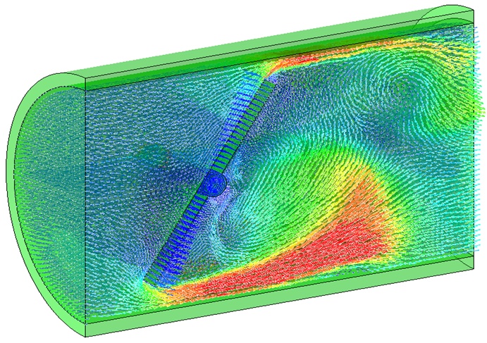

The output database files for both the fluid and structure jobs are opened simultaneously in the Visualization module and are overlaid in the viewport.
  1. Toggle off the overlay plot option  in the toolbox.
  2. Create pressure and velocity contour plots
  3. Create velocity contour plots and animate them. A plot of the velocity contour is shown below
Figure 3. Velocity vectors across the valve.

A detailed video of setting up the simulation from scratch and visualizing the results is attached herewith.
The CAE file is also attached here.
