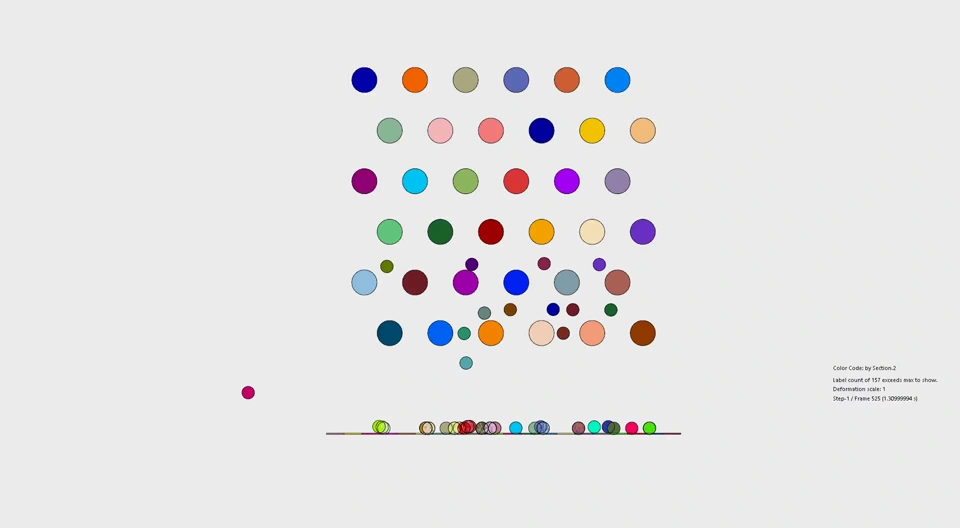

This is a 2-D Abaqus/Explicit simulation of 100 small rigid disks falling under gravity through a grid of larger rigid disks. The initial positions of the falling disks are very similar, but they end up scattered widely by the time they fall as far as the plate at the bottom. The animation is from the Physics Results Explorer app. There is no contact between the falling disks.
