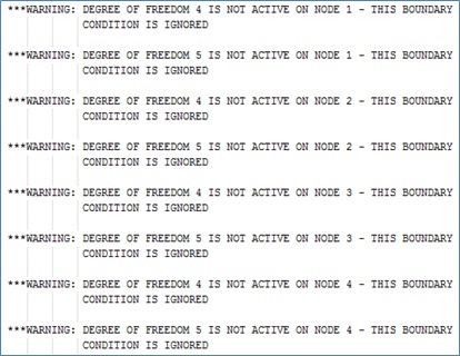

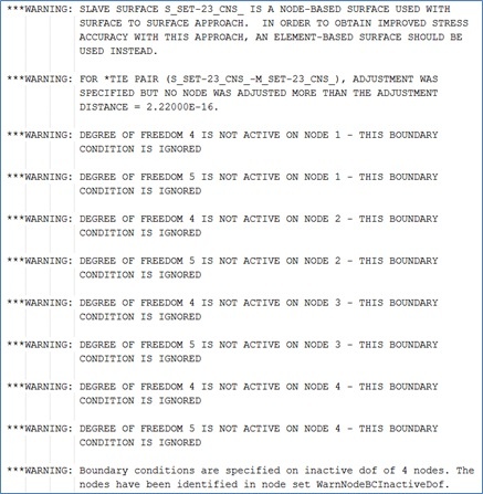

On execution of the script for  ‘cantilever .dat’ file, all the warnings are written out to “cantilever_warnings_bulk.txt” as shown below :

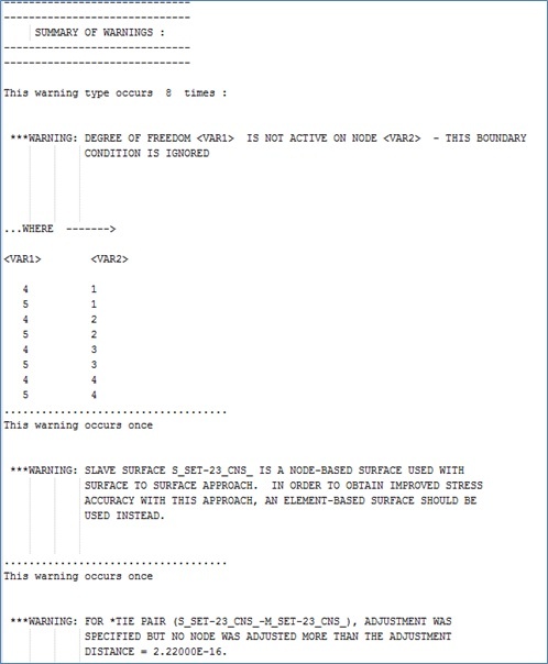

The summary log file is also generated and will contain the warnings in the format shown in the picture below:

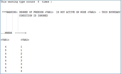

You will notice that for warnings of the same format, the dissimilar characters (or variables)  will be printed out in the form of a table with headings as VAR1,VAR2 e.t.c, with each “VAR” represented the variable part of the warning format that repeats itself.
For example in the picture below, you will notice that the following three warnings have a similar format, except for different degree of freedom value and the node on which it is active. These two are the variable values for this warning format under discussion.
For each similar format of warnings, the varying words/strings are printed in the form of a table, with headings as VAR1 (for the first variable) representing the DOF number, VAR2 (for the second variable) representing the Node number in this example.
This format makes it much easier for the user to look through the warning messages and understand which regions of the model are connected to the warning messages. The number of times this warning/error type occurs is also printed in the summary file. In addition, warnings/errors that occur multiple times are written first, and those warning/error types that occur once are written later.
