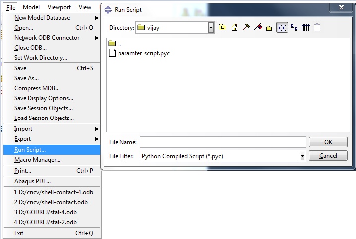

  1. Place the parameter file, Abaqus input file and the python script (parameter_script.pyc) in the same folder
2. Open a fresh session of Abaqus CAE with the working directory pointing to the location of the aforementioned files
3. Run the python script

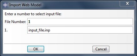

4. A table listing all the input files in the working directory would come up. Here you would need to select the master input file if there are any references to associated include files. Else you can select the only input file.
