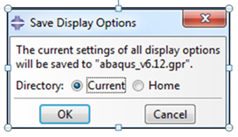

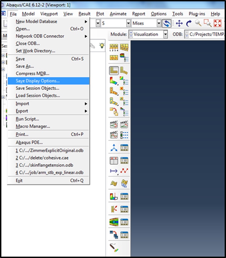

After the display options are customized from the main menu bar, select FileSave >Display > Options to save all the current display options settings.
The Save Display Options dialog box pops up and provides you the option to save either in the current directory or in the home directory.

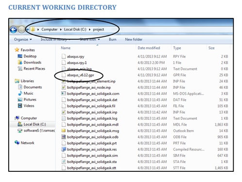

The current directory option stores the .gpr file in the current working directory. In addition, it also propagates the display settings to all the .odb files present in the current working directory.

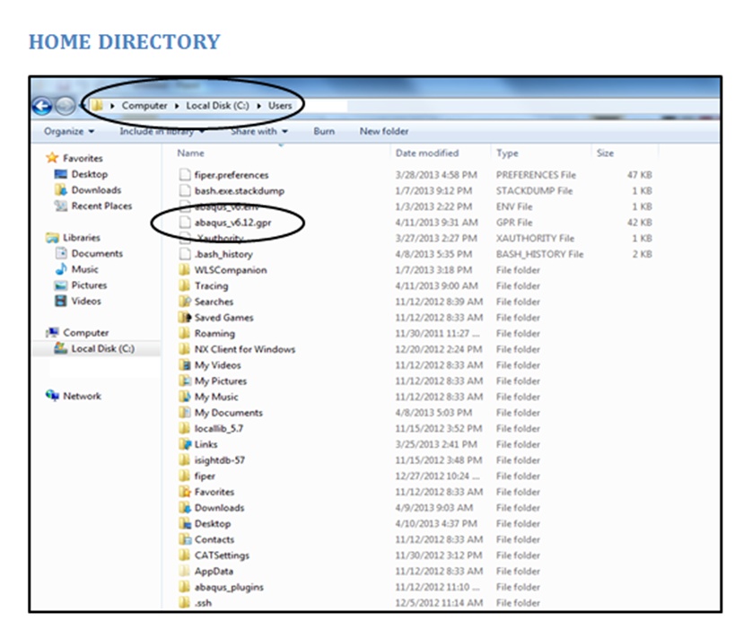

The home directory option stores the .gpr file to the user’s home directory and the display settings propagates to all the .odb files opened in that particular Abaqus version, in this case version 6.12.

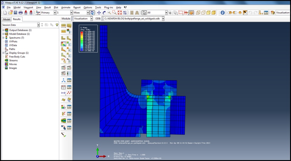

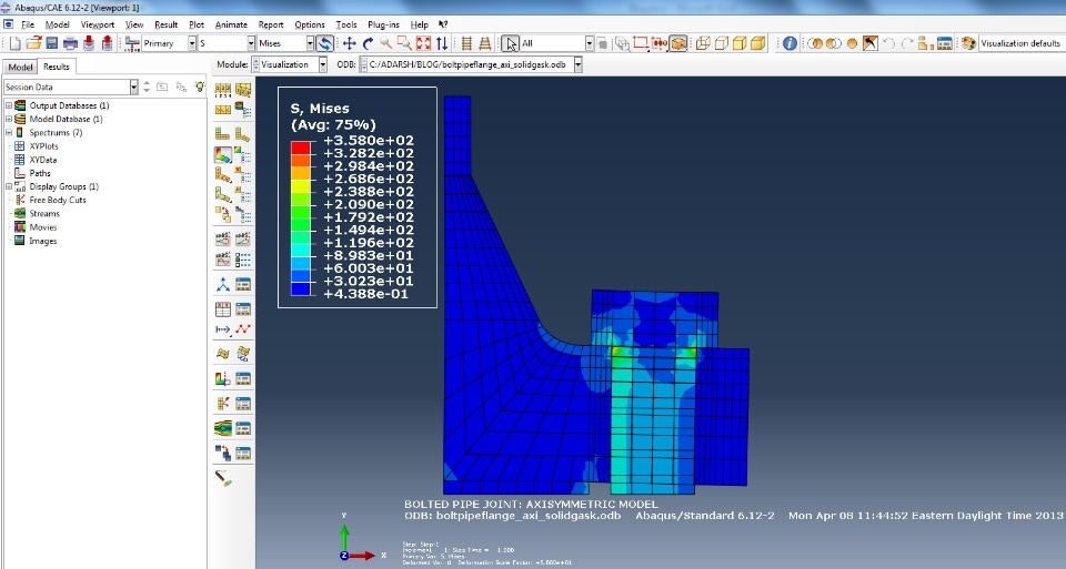

Let’s assume that you want to change the legend font size from the default 8 to18 and save it in a gpr file. Figure 1 shows the odb file of bolted pipe flange analysis.

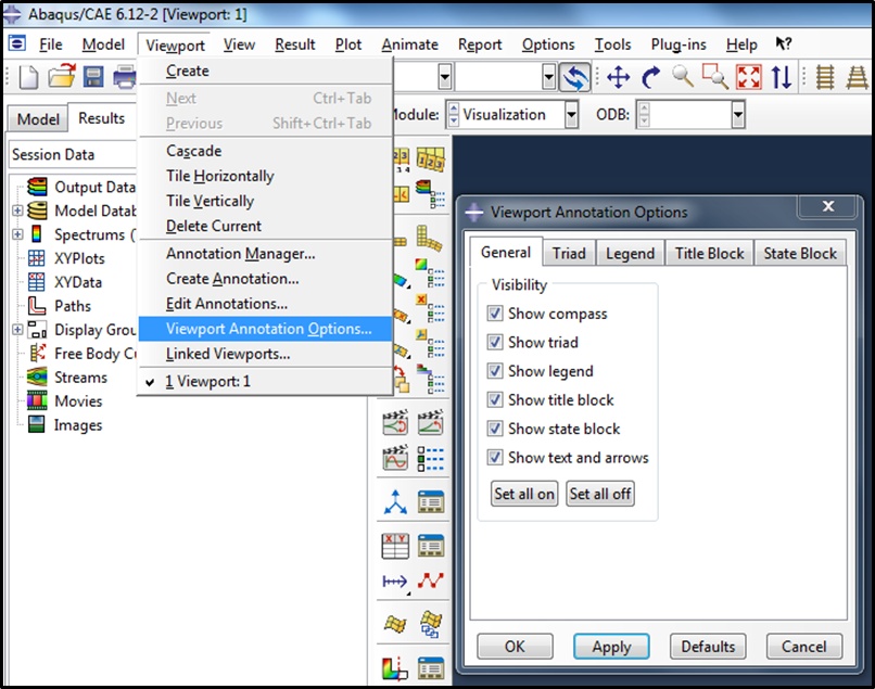

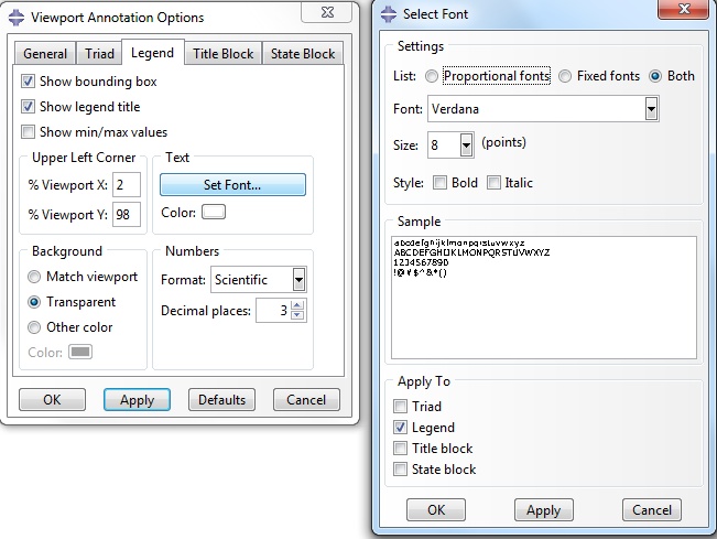

Navigate to the “Viewport Annotation Options…” as shown in the Figure 2. Click on the legend tab and press “Set Font…” button. Select font dialog box opens up. Change the size from 8 to 18. The legend font size is changed as shown in the Figure 4. Repeat the same procedure for title block or near the bottom of the current Select Font window you can check other areas to apply these same changes such as the Triad, Title block, and State block.

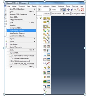

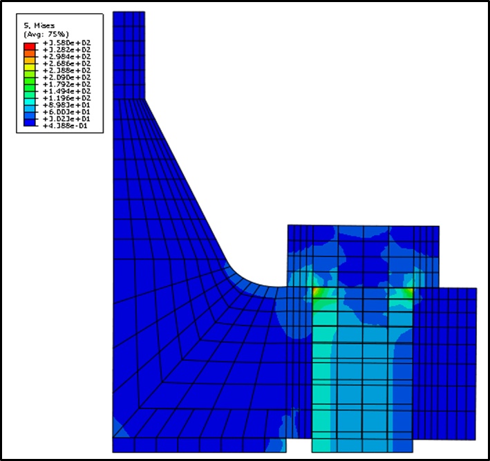

Save the display options to create a .gpr file (Figure 5). For detailed information follow the ‘steps to create a gpr file’ in page 1.
Close the Abaqus viewer and open the same odb file to see the legend font size to be 18.

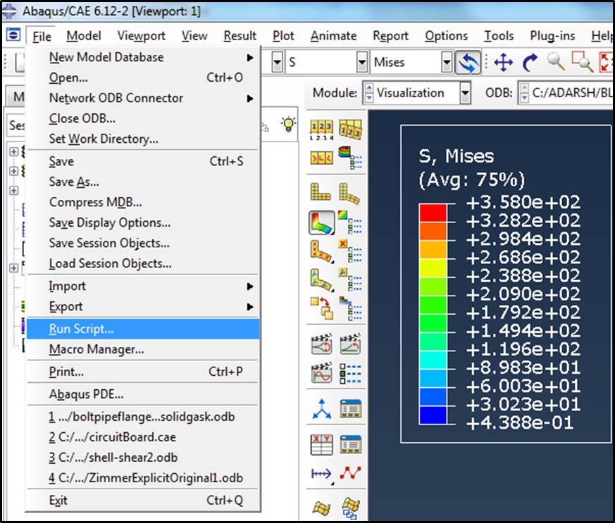

Then when you open the .odb file next time, you can run the python file using FileRun Script.

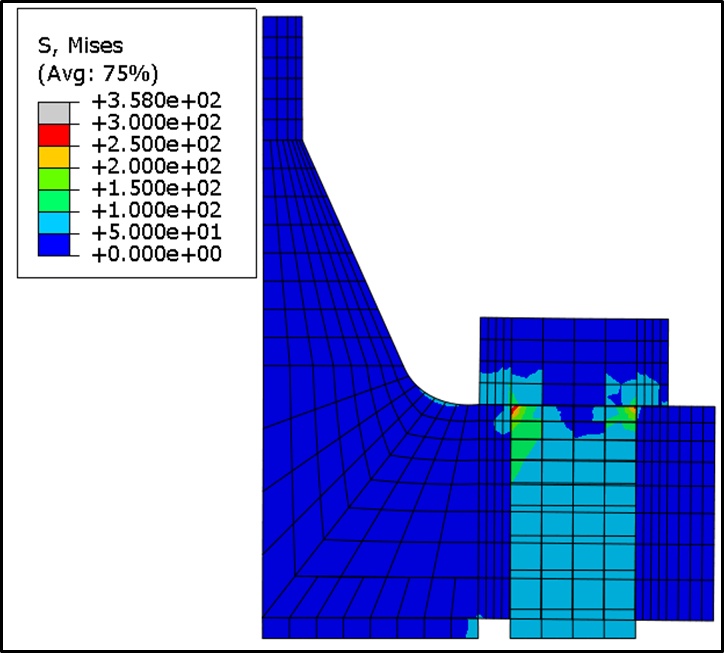

Attached is a sample python file, demo.py created by performing the operations in Viewer and then copying from a abaqus.rpy file. The python file changes the legend font size to 18, changes the maximum value in the legend to 300, minimum value to 0 and the number of intervals to 6.
