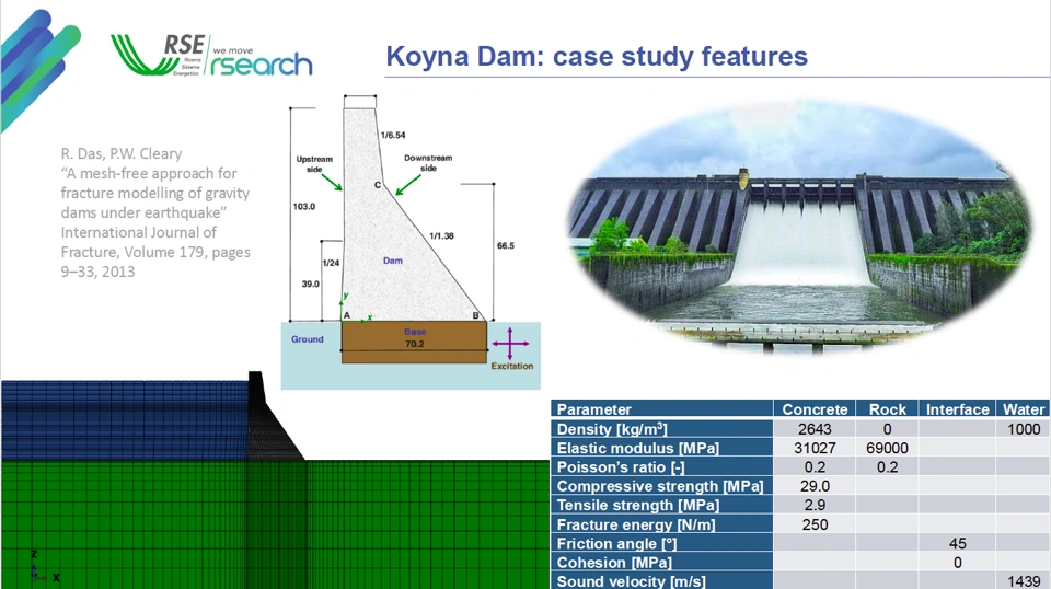

The cracking behavior of concrete dams under seismic loading is investigated by comparing the results of two different modeling approaches available in Abaqus: the Extended Finite Element Method (XFEM) and the Concrete Damaged Plasticity model (CDP), more experienced by the authors and widely used on concrete dam applications. Several case studies are considered, both two-dimensional (Koyna Dam, India, and Pine Flat Dam, California) and three-dimensional (a large double-curvature arch dam, ideally inspired by Tzakov Kamak Dam, Bulgaria).
