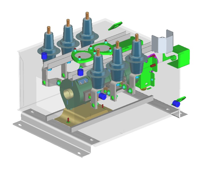

The device used in this study is a G&W Electric Rotary Puffer (RP) type, two-position switch. This is ideal for manual load break switching, sectionalizing applications rated through 25kV, 630A continuous current. The intention is to establish temperature rise for both SF6 and CO2 gas types. CO2 was chosen since many proposed alternatives use this gas in their formulation. Any arbitrary gas mixtures can be simulated provided that information about their gas physical and thermal properties is readily available. The complete study can be found in the paper at the 22nd International Symposium on High Voltage Engineering, Xi’an, China 2021.
A fully featured CAD model of the load break switch shown in Figure 1 was imported.
Figure 1: Rotary Puffer load break switch under investigation

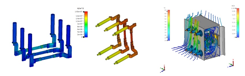

This model serves as a master model for a combined electro-thermal workflow based on a low frequency solution for electric current flow in the three-phase conductors at 60 Hz and a Conjugate Heat Transfer solver (CHT).  The workflow is performed in single user interface and enables automatic and seamless connectivity between the simulation types.
In order to model the physics correctly, it is critical to include the contact resistances at critical joints  in the current conductors. These contact resistances lead to temperature rises in the device. However, contact resistances depend on materials and construction e.g. applied torque. There will be significant variance between their values in the equipment. These values can be measured at strategic locations and their values integrated into both the low frequency and thermal models. The low frequency losses are automatically imported into the CHT model. Eddy current and thermal results are shown in Figure 2.
Figure 2: low frequency current density and temperature rises in the bus bars and streamlines of CO2 (inside) and air flow (outside)

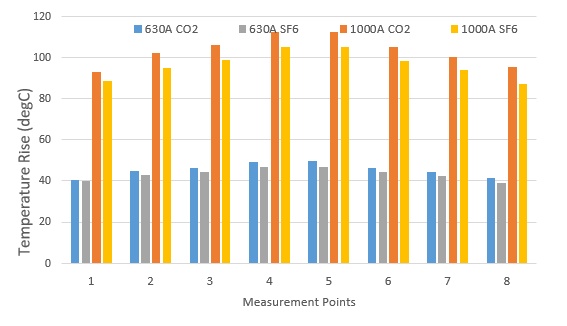

A verification of the process is shown in Figure 3. The strength of simulation is that parametric analysis allows the operating conditions to be investigated. Simulation results for both SF6 and CO2 at nominal and increased load are shown in Figure 3. Overloading, as expected, leads to dangerously high temperatures. Such studies enable margins to be determined in the design phase.
Figure 3: Simulated temperature rise comparison at normal (630A) and overload (1000A) conditions

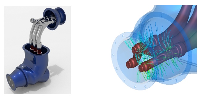

A simple example of a medium voltage switchgear is presented in Figure 4. The user simply enters the material data and attributes voltage levels for each of the three-phase conductors under the assumption of an arbitrary short circuit condition. The streamlines are automatically calculated within the device or at locations of interest specified by selecting relevant surfaces. A post-processing step carries out the streamer calculation to establish the inception and breakdown voltages. The streamlines emanating from these locations can be visualized. Surface fields or streamline-based results can be used to optimize the topology or distances between components as well as determine safe margins of operation.
Figure 4: Geometry of a medium voltage switchgear and calculated streamlines

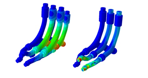

It is important to establish the mechanical stresses that switchgear are subjected to under short circuit conditions. A transient low frequency solution provides the forces on bus bars at particular instances in time during a system fault. These forces are consequently used to determine the structural integrity of the system e.g. optimal location of conductor supports. Figure 5 shows the deformations in the switchgear resulting from a typical fault. This simulation can be integrated into the overall switchgear design process.
Figure 5: Displacement and stress results for a switchgear subjected to a fault condition
