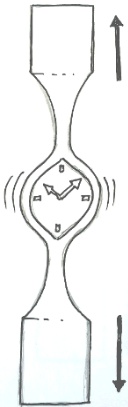

(Cartoon of a Dogbone Sample with an internal “clock”)
Reduced time models require the complete, linear viscoelastic property matrix. Materials can be thought of as having an internal time clock, which is accelerated or decelerated (ie, reduced) based on thermodynamic state variables like strain, temperature or pressure. The sole commercially available alternative is a Dynamic Mechanical Analyzer, but DMA’s only produce one viscoelastic material property, when the entire time dependent stiffness tensor is needed.
