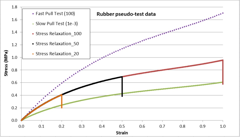

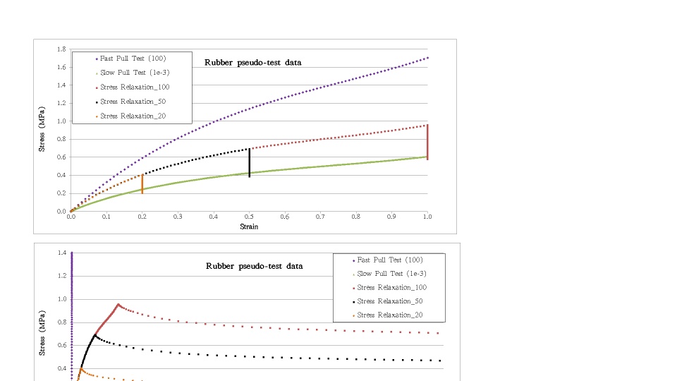

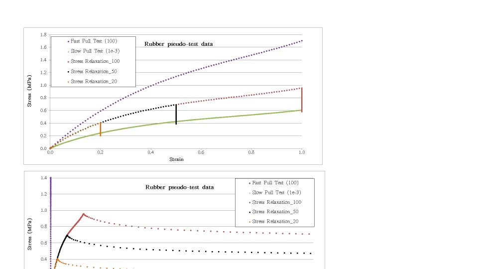

This data has been quite useful to me and perhaps you might find it useful too.  From our elastomer class at Axel Products, I had some test data for a silicone rubber material.  But, for calibration purposes I wanted to have a wider suite of test types.   So I took the limited set of test data that I had and created a reasonable Yeoh+Prony linear viscoelastic material model for it.   Then I used a series of Abaqus runs (using a unit cube) to generate a fuller set of test data.   Now, I have a fuller set of test data for trying out calibration strategies, but I also now have the "right answer" since I know that all of this pseudo-test data originated from one single set of Hyper+Prony coefficients.  There are a total of
3 tests - fast, mid and slow rate tests, all uniaxial, monotonic pull-tests.
3 tests - uniaxial, biaxial and planar at a strain-rate of 1e-2
3 tests - uniaxial, biaxial and planar at a strain-rate of 1e-1
3 tests - stress relaxation to initial strains of 20%, 50% and 100%.
The material model that i used to generate all the pseudo-test data is:
